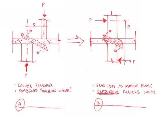

Please review the sketch below (and attached). I am curious what others do to check slabs at column transfer locations. I'm thinking of "walking" columns in thinner slabs but the discussion is equally germane to full blown podium style transfer slabs as well.
The options:
1) Individual column punching shear with small moment.
2) Combined column punching shear with large moment.
3) Shear friction in the slab between columns.
4) Bearing stresses.
5) P x e moment in slab.
6) Vertical seismic acceleration effects.
7) One way shear between columns, similar to #3 (forgot to draw this)
I believe that the following checks are fairly standard: 1,4,5,6. Combined punching shear (#2) is a KootK invention as far as I know. Shear friction (#3) is standard practice at one of North Americas top tier structural firms. I feel that it's unnecessary as I can't imagine that ever governing over the diagonal shear failure modes (punching & potentially one way).
So, what do others check? And I'm not looking for FEM solutions. And I know it's awful.

I think that this is a completely different animal. In the other discussion, the effect was secondary and not required for equilibrium. Here the effect is primary and absolutely required for equilibrium. In the section view of #2 above, I showed a section of the slab rotating under the effect of P x e. Something needs to prevent that from happening. As I see it, the choices are:
1) Fixity between the columns and the slab. Due to detailing limitations, it seems sketchy to count on that.
2) Bending forces applied to the perimeter of the slab section. Due to the small area involved, flexural capacity will be insufficient.
3) Eccentric punching shear. I believe this to be the dominant contributor.
I've already rationalized it into something that can be put on paper. In the plan view of #2 above, I've defined the punching shear perimeter explicitly. Other than the odd shape of the punching perimeter, this would be the same as a regular eccentric punching shear check.
As I mentioned, I'm considering a case where the columns are in close proximity and the chunk of slab that punches would be fairly rigid. Once the the distance between columns becomes large, slab flexibility would kick in and a punching shear model would no longer make sense. Is that distance 8 x slab thickness? More? Less? Dunno. We're off the reservation here.

For #2, I assume you refer to the shear increase from moment transfer from the slab to the column. A good reference on that is ACI 352.1 R-89. They've got some examples and it includes a discussion on proper reinforcement details and the effect of openings in the slab.

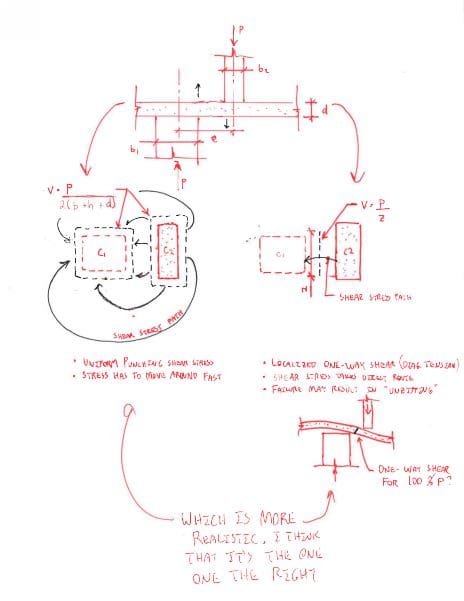

It is actually #7 that worries me the most. It's the same as #3 but one-way diagonal tension shear (Vc) rather than shear friction. See the attached sketch. When the columns are spaced further apart, the shear stresses have time/space to shift around. In that case, I think that punching checks on the individual columns makes sense. When the columns are close, however, my gut tells me that the bulk of the shear makes its way across the slab via localized one way shear.
Well... yes. What I have suggested is actually quite unconventional however. In fact, I've never seen it proposed anywhere. It's a punching shear perimeter that encompasses two, offset columns and transfers P x e moment into the slab. Procedures for checking eccentric punching shear on a given perimeter are fairly well established. The big question here is whether or not the check is required.

By 1) are you saying that you assume no fixity between the slab and column? Typically if this is a transfer slab it's relatively thick and the typical detail would include matching dowels up for the column, I wouldn't consider that a pin. That also means that in your punching shear checks in general you have no unbalanced moment which makes up a good majority of the demand.
If it was me, I would only consider the perimeter provided by the one column (on the bottom). The one on top is loading the slab/column.
In a real design of a thick transfer slab, I generally would consider fixity. For this discussion, however, I have assumed pinned connections for the sake of simplicity. Assuming fixity in this discussion introduces new forces which muddle things and don't materially affect the arguments being proposed. That's my opinion at least. If I'm wrong about that, I'm interested to hear more.
This has me worried WARose. At minimum, the upper column needs to have an individual column check to ensure that it won't punch downards through the slab. Take my sketch, flip it upside down, and take another look at the situation. I'll think that you'll come to see that both columns require punching shear checks.

Both do require punching shear checks (one for each).....but I thought the combined perimeter was non-conservative.

KootK, For #2. As you've sketched it, wouldn't a quick initial check to see if it's a concern be P*e/(l*b*d) where l is the overall length of the piece of slab from failure line to failure line, b is the smaller length of failure line (next to the smallest column) and d is slab depth. This would give you a shearing stress on that face which you could compare to vc. If it's close then a more accurate analysis may be in order, if it's not than no further check is required.
That calc can't take much more than 5 minutes and would put you at ease (or on alert)

Ah... now I get it WARose. I wasn't suggesting the combined perimeter instead of the individual column punching shear checks. Rather, I was proposing that the combined perimeter might need to be looked at in addition to the individual column punching shear checks. The combined perimeter is relatively long but the moment that it needs to resist may be very large (P x e).

I'd still like to get some thoughts on #7 and my last sketch. If that's a valid failure mode, the rest is just window dressing.

As for number 7. How do you determine the length of the one way shear failure plane? I think it is likely that it may start failing in one way shear directly between the columns, but once the cracking reaches the edges of the columns it would need to turn into two way shear. There is no way it is going to cause one-way shear for the whole length of your slab.

Quote (Jayrod)
The difficulty I have is how to account for the fact that the direction of the shearing stress switches somewhere along the perimeter. I see the hunk of slab as more of a beam trying to rotate about it's centroid then I do as a lump of concrete getting punched out.
Does this clear it up Jayrod? The diagram at the right. You could have a chunk of concrete loaded entirely in flexure, with no axial load, and still have a punching shear failure. In fact, the situation that we're discussing is probably getting close to that.
Precisely. I've seen no guidance on this. I would think some multiple of the slab thickness would be a good rule. If only I knew what that multiple was... I know Bookowski would like to know too.
Quote (Jayrod)
Agreed. In my original sketch, I mentioned that I thought that a shear failure initiated as one way might morph into an unzipping style punching shear failure around the perimeter of the column. Whether or not that's a possible failure mode is an important part of that discussion.

I would say it should be considered as a failure mode. But my guess is that by the time you check the individual punching shears those likely govern except in extreme cases as the one you are illustrating. This example is an extreme case and highly unlikely. If this amount of offset was in the original plans we all (at least I think we all) would find some way to use more concrete to transfer the load into the offset column below.
But that's just my thought.
As for the diagram you posted, that is what I envisioned however, your punching shear perimeter on the original problem is not only unbalanced moments, you have punching shear stresses in both up and down orientations from moment and column loads. So when I imagined the total shear stress diagram there would still be an inflection point where the total shear stress is practically zero.
This sort of depends on how you see things. As I mentioned above, I've been assuming that the difference between a one way shear appropriate situation and a two way shear appropriate situation to be whether or not I expect that the shearing block will behave more or less rigidly. If it is rigid, then you can aggregate the effect of all the moments and axial loads into a single, representative moment and axial load (like we do with eccentric footings).
With a single moment and axial load on an assumed rigid body, I feel that you'll get diagrams like I've posted above. Whether or not the shear crosses zero and flips sign would depend on the ratio of moment to axial force. In these transfer situations, the moments tend to be rather high and the only net axial force is the contribution from normal slab support loads. As a result, I usually do see a punching shear stress diagram that crosses the zero line.

With respect to the one-way shear failure (#7), I'm attracted to the notion of running stud rails between the two columns. Ties for thicker slabs.
The greatest trick that bond stress ever pulled was convincing the world it didn't exist.

But are you laying out your studs and ties to reflect the
two way check (#1) or the one way (#7)? I've never heard of the latter. And it would take a TON of studs in many cases.
RE: Checks Required at Concrete Column Transfer Slabs (Walking Columns)
One way definitely, just was doing this last week in fact on project similar to what you were describing as typical (upper floor setback with three levels above setback).
What I do is show a line with a light plot style and dashed over a width and actually tag it with a beam tag. I usually also provide a section because I know it's likely to get missed/confused, I figure that beam tag + section mark should make it obvious. Basically I build a beam in slab.

I must be missing something... I see the offset column as a source of vertical load and moment, as well as lateral in EQ case, into the slab. The design of the slab is for the shear, moment, etc loads imparted. The design "stip" of the slab taking this is the perpendicular width of the slab plus 2d each way (standard punching shear provision).
What have I missed? Why is this causing a wide-reaching debate with some of the smartest folks around here.
Note: It is late, I am tired, and I just would rather ask and feel stupid in the morning than not ask and potentially miss an opportunity to learn.

@CEL: my intention with the thread was twofold:
1) I wanted to take a survey of what folks are checking in this situation and, hopefully, get some new ideas. While the group here seems to be pretty in tune with one another, I know that there is considerable variation in practice. My impression is that most folks just do checks one and five. Obviously, I seem to be a lone wolf when it comes to check number two.
2) In this situation, it is not at all clear to me whether one way or two way shear checks are appropriate. I wanted to get some input on that. My gut says -- as you seem to -- that it's predominantly a one way situation. However, I still "feel" the need for check number two. And that strikes me a permutation of punching shear.
So, now that you're here, which of the seven proposed checks do you support? Any additional ones? Why do we use different stresses for one and two way shear? Just different test results? I feel that it has something to do with the rigidity of the section that punches through and the capacity for shear redistribution in plan.

Okay... Well to start I don't see a low and a high moment, but rather the one moment caused by the offset of the columns. Are you meaning they in one case you accept reduction by returning moment of the slab?
As.for the checks, I also don't see the combined column punching shear. This feels a bit like a doubling of forces - Personally I think you've muddled the source of a load with the design of how to resist said load. I stand ready to be corrected...
The check of the shear through the slab is the core requirement. All else is secondary, even the flexural case. I doubt flexure would govern many of these, and even if it did, it is unlikely to be more than theoretically governing.
I'd be a 1-5-6&7 guy... With a long term creep check thrown in as well if the propodtions of the spans made me feel it was warranted.
Lots of engineers don't think of creep often enough; I've seen some very odd situtions with creep, and have learnt enough respect to keep it in mind.
I also think I'd be likely to request a drop beam to I make this all easier to do...
Yeah, with respect to check number two, either you're all right and I'm crazy... or the reverse. Probably the former. I'll take one last stab at trying to sell the combined punching shear check. Consider the sketch below which depicts two situations:
1) The offset columns where the moment is P x e and it is dubious whether or not a punching shear check is required. Mode number two above.
2) A stacked column situation where the columns and slabs form moment frames for lateral resistance. Moment is still P x e but, here the need for a predominantly rotational punching shear check is obvious.
How about that? Anything? Does this resonate with anyone else???

Rapt: I agree that the total load along this like (between the two columns) must be checked as a direct shear case, but this does not force the use of beam shear equations. It just has to be directly checked.
I think that we still will need a punching shear check, just a three sided one.

@CEL: There may yet be something to discuss here. I believe that the consensus opinion is that the predominant check truly is a one-way beam shear check on the concrete between columns. It leads to these two important questions:
1) How wide of a "beam" should one assume for the one way check and;

If the gap between the columns is small enough (< 1.5D), there is no shear to check for. It is a pure strut tie situation and the diagonal compression strut transfers the load from the column above to the column below. To be safe, you could also check it for beam shear but would use a very high shear angle as the normal minimum strut angle assumption of 21.7 degrees (EC2) to 45 degrees (some very outdated codes) would not longer apply as the direct strut angle would be higher than this, and it cannot be less than the direct strut angle! That is why some codes give an increased shear strength factor at locations closer than 1.5D from the support for loads applied near the support.
In my younger days I would often check this as a shear friction case as well ensuring that the reinforcement supplied for the tension strut also satisfied the shear friction rules for monolithic concrete. And put some horizontal reinforcement in the top half of the member for this and also some extra ties to give the same area vertically but I think this was probably overkill.
If the gap between the columns is > 1.5D, it is flexure shear and use the appropriate code equations, preferably from a more modern shear design method like the Canadian or the Eurocode which address the strut angle requirements better!
Between D and 2D, I would check it both ways!

I definitely believe the 1-way shear model should be checked. Then the question becomes how long of a line of the slab should be used for the check? I would use the distance between your 2-way shear lines that you drew at the beginning of the post. T would add the capacity from a 3-sided 2-way shear check to the capacity for the 1-way shear between the columns. Check whichever column has the higher 2-way shear stresses and place the 1-way shear failure line half-way between the columns. With this method you would need to use capital Vu and Vc since you need the whole perimeter to breakout for a failure. Based on this, you no longer need to check 1-way shear when the capacity of your Vc from the 3-sided 2-way shear plus 1 way shear capacity exceed the shear capacity of the 2-way shear for a single column.
I would check situation 2 as well since adding a beam within the slab between the columns would be of no benefit in this situation. The failure planes are entirely outside the columns. You could theoretically run a beam between the columns and have very thin slabs outside of the columns. However, in this case the shear has to change signs so that part of the slab can punch out down and the other part up. Therefore, the parts of the slab that are parallel to the elevation views you have drawn will need to fail by torsion. I'd grab the torsional components of the slabs from ACI 421.1R-99. If both the torsional and 2-way shear are greater than allowable, the section fails. Now here's where it gets a bit convoluted. If either the 2-way shear capacity or the end faces or the torsional capacity of the side faces are greater than the allowable, "borrow" some of the orthogonal faces. Eg. if the torsional side face resistance of the slab fails use enough of the end face until the torsion is satisfied. Then recheck the 2-way shear with the "borrowed" portion of the end faces no longer included in the 2-way shear check. If you can get both torsion and 2-way shear to pass then the section will be okay. If you can not get both to pass the section fails.

I believe that it is important that KootK prove to his own satisfaction that the combined shear case is not real, he should not just take our words for it.
I still wholeheartedly believe in the combined punching shear check (#2). I only stopped selling it because it became clear that others were not being persuaded by my arguments.
Yes! Finally, an advocate for the combined punching shear check (#2)! I agree completely and should have thought of this argument myself. The one way shear resisting beam element envisioned, on it's own, does nothing to resolve the P x e rotation problem. The rotation of the combined perimeter encompassing both columns can only be addressed through slab moments and/or eccentric shear around the combined shear perimeter (effectively torsion when the stresses are taken in aggregate).

Late to this one, but agree with rapt. Short offset transfers are strut and tie, and long offset transfers can be done that way as well, but are usually treated as conventional flexural problems.
As to studrails, we had a discussion some time ago, which has never been resolved to my satisfaction.

With regard to the stud rail concerns, I wonder if one is any better off with conventional ties or if similar issues crop up there too. The insufficient flexural issue ought to apply in both scenarios.

I'd be perfectly happy if the codes mandated that all two way shear be dealt with using concrete strength alone. For better or worse, that cat is very much out of its bag. I just assume flat plate and studrails nowadays. From a construction economics standpoint, that's usually the right answer.

Being an older engineer, that was always out preference. If punching shear did not work, add a column capital to increase the shear perimeter of a drop panel to increase both the perimeter and the effective depth until it worked. Never use shear reinforcement except possible in very deep transfer slabs.
I still do not accept that you can justify punching shear reinforcement in thinner slabs. BS and EC codes limit the slab thickness to a minimum 200mm for punching shear reinforcement, but I think this is still too thin.
And there should be a rule like the CSA one requiring a minimum area of bottom reinforcement continuous through the punching zone in the bottom of the slab in both directions in all cases. This provides an enormous increase in the FOS against brittle collapse in a punching shear failure situation for nominal cost. This actually came out of the Studrail testing, where they tested different slabs with terminating rails and continuous rails and the ones with continuous rail had FOS against collapse of 2-3 times those with terminated rails.
