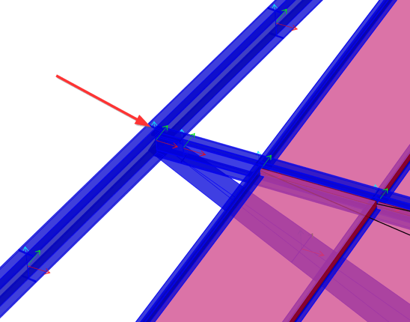

For example, we have this part of the structure that has a connection that we would like to model.
Which, translates into a 3D model as this one:

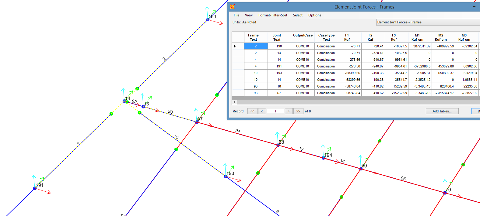

a- Create nodes on the Frame model that are the same as the ones shown on the on the 3D model.
b- Read the joint forces for the cropped members on their tip for the desired combination. The following image shows this.
http://forums.autodesk.com/t5/image/serverpage/ima...
c- One of the nodes, the node 193 in this case, is set as being completely fixed (translation and rotation).
d- Compare the loads resulted from the 3D plate model on node 193 with the ones from the FRAME model. If they are the same, the model is OK.

Apply these to the plate model, and fix the model according to the 1, 2 ,3 method (free free) with three points. The points should be at a place, where no load or constraint is acting. If all is well, the loads in these points will be very low.
Do not forget gravity.
