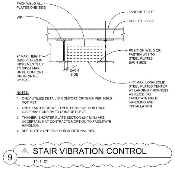

If your framing is such that it would make sense, your client can roll the dice and then possibly add a mass damper to the girders at some point in the future to remedy any vibration issues that arise. I know at least one marquis structural firm that will routinely include a mass damper on their feature stair designs even when those stairs have been designed for vibration. It's just so hard to predict vibrations issues that it's prudent to give yourself an easy way to fix them should problems arise.

Kootk, I'm not too familiar with how a mass damper would be installed or what it even looks like. Could you explain how that would work?

Be extra careful with OWSJ. Often, adding concrete mass is the only way to deal with vibration. It seems that there's not all that much that one can do to the joists to improve matters. 5" min slab thickness usually seems to be appropriate.
The detail below is the one that I was thinking of. Pretty low tech really. Still, if you pitch a mass tuned damper on an industrial mezzanine, expect to see some raised eyebrows.
