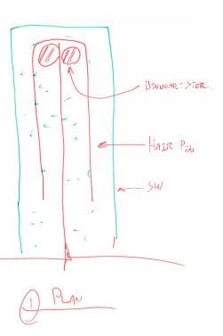

I guess I should elaborate a bit. It really depends on the thickness of the wall. If the wall has low enough loading to only require one layer and it has an unsupported edge, I will use two layers at the very edge of the wall and a #3 hairpin at the same spacing as the horizontal bars. If it occurs at an intersecting wall, I use corner bars lapped with the horizontals like you mentioned. I really only use the one layer with a 180 degree hook on the vertical bar in 6" walls. That's only because there isn't enough room to fit the bend diameters in the wall.

Six inch shear walls? I want in on that. Is this how it works:

Yes, I show the bars come in towards the horizontal bar, but I doubt it's ever constructed that way. The U-bar is more likely what they install since it easier to bend.
RE: Concrete shear wall boundary elements
I bet that they place the hairpin around the boundary bars and then twist it as vertical as they can so that it can be tied to the horizontal reinforcing. Come to think of it, that would work nicely in place of the 180 bends in six inch wall as well.
The question that I have here is the extent to which this arrangement constitutes confinement in the direction perpendicular to the wall. Normally, you're tying a bar on one face of a wall to another bar on the opposite face, engaging most of the wall thickness. Here that's a bit more questionable. Both bars might just buckle laterally together which would make tying one against the other pointless.
