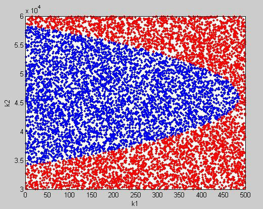

I have the following code:
clc
clear all
d1=1.6256;
d2=0.77;
d3=0.815;
b=11;
m=967.44;
Ig=9759.19;
V=73.05555;
rho=1.225;
dCL=10;
a11= (1/m)*(k1+k2);
a12= (1/m)*((k1*d3)-(d3*(k1-k2))-(0.5*dCL*rho*(V^2)*d1*b));
a21= (1/Ig)*(d3*(k2-k1));
a22= (1/Ig)*(d3*(k1+k2)-(0.5*dCL*rho*(V^2)*d1*b)*(d1-d3)-d3);
A1=[0,1,0,0;-a11,0,-a12,0;0,0,0,1;-a21,0,-a22,0];
eig(A1);
A=((a11+a22)/2)
B=((a11*a22)-(a12*a21))
I am trying to find the values of k1 and k2 (between 0 and 7e6) that give the results of B>A^2. There is likely to be multiple values so if I could plot them in to a contour plot of k1 vs k2 then it would help.
Can somebody suggest how this would be possible?

My code has actually changed a little:
clc
clear all
%% Set Variables
d1=1.6256;
d2=0.77;
d3=0.815;
b=11;
k1=3000;
k2=100;
m=967.44;
Ig=9759.19;
V=73.05555556;
rho=1.225;
dCL=10;
%% A values
a11= (1/m)*(k1+k2);
a12= (1/m)*((k1*d3)-(k2*(d1-d3))-(0.5*dCL*rho*(V^2)*d1*b));
a21= (1/Ig)*((k1*d3)-(k2*(d1-d3)));
a22= (1/Ig)*((k1*(d3^2))+(k2*((d1-d3)^2)-((0.5*dCL*rho*(V^2)*d1*b)*(d3-d2))));
%% State Space A-Matrix
A1=[0,0,1,0;-0,0,0,1;-a11,-a12,0,0;-a21,-a22,0,0];
%% Eigenvalues
eig(A1)
A=((a11+a22)/2)
and my ranges are now from 0 to 7e3. On a graph I need to plot all the values of k1 and k2 that give the following results:
B < 0
0 < B < A^2
B > A2
Can anon suggest code that would allow me to do it?

Well sure, I could write the code, I think it needs a maximum of 7 new lines to do that, and 2 modified ones,but I rather wonder what you'd learn from it.
The question "I need to plot all the values of k1 and k2" itself is ridiculous since there an infinite number of pairs k1 and k2 that will satisfy the relationship. I haven't got that long.

clc
clear all
close all
%% Set Variables
num_runs=100000;
d1=1.6256;
d2=0.77;
d3=0.815;
b=11;
m=967.44;
Ig=9759.19;
V=73.05555556;
rho=1.225;
dCL=10;
k1=7e3*rand(num_runs,1);
k2=7e3*rand(num_runs,1);
%do a little simple maths, eliminate redundant lines
a11= (1/m).*(k1+k2);
a12= (1/m).*((k1*d3)-(k2*(d1-d3))-(0.5*dCL*rho*(V^2)*d1*b));
A=((a11+a22)/2);
B=((a11.*a22)-(a12.*a21));
%plot the results
plot(k1(B<0),k2(B<0),'b.')
hold on
plot(k1((B > 0)&(A.^2>B)),k2((B > 0)&(A.^2>B)),'g.')
plot(k1(B > A.^2),k2(B > A.^2),'k.')
xlabel('k1')
ylabel(' k2')
legend('B<0','0<B<A^2','B>A.^2','Location','Northwest')
Let me know what your professor thinks.
Cheers
Greg Locock
