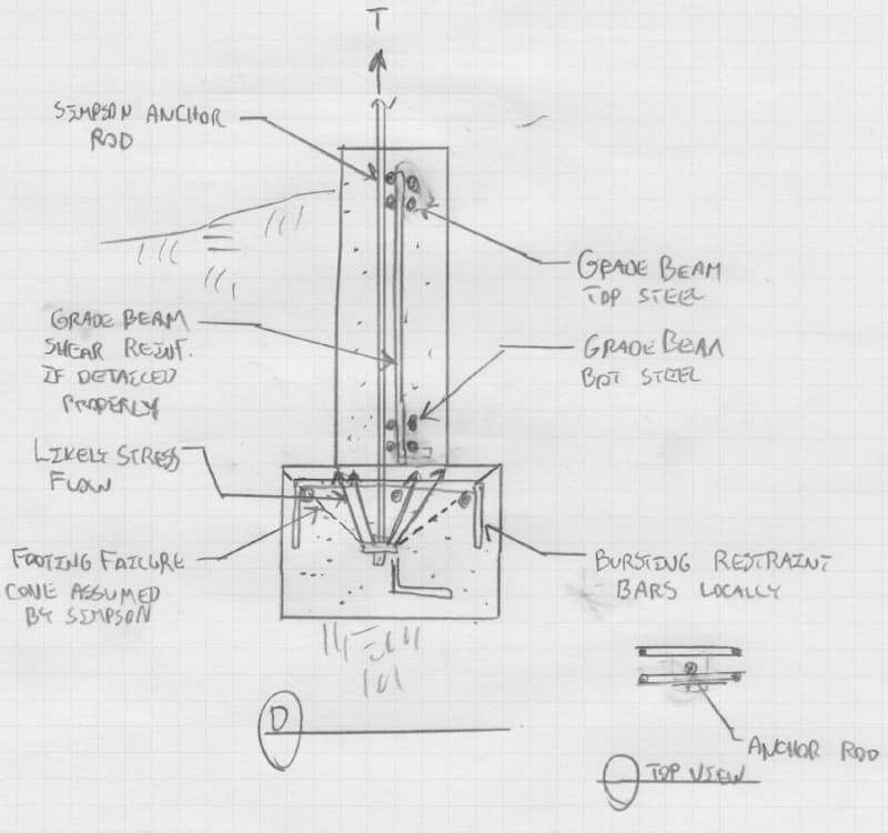

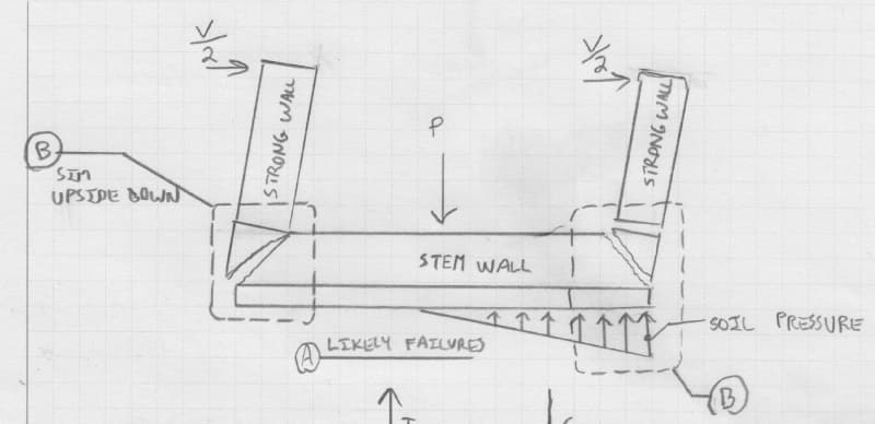

Make sure to pay attention to the foundation requirements for the walls...basically the same as you would do for the steel strong walls.
On another note, not related to shear walls but beams, Boise Cascade produces a "King Beam". It's a great product and cheaper than other engineered beams if you need something other than a typical glulam. Just thought I would throw that out there since you are relatively "new" to wood design. Lots of designers don't know about it.
RE: Wood Shear Wall Software or Spreadsheets
Here is how the wall looks with a couple of SWSB18 on either end (not all the notes are added yet, so forgive the mess):
A confused student is a good student.
Note the depth of the footing. The min. embedment is 6" and then you need at least 5" clearance from the bottom of the footing to the anchor bolt nut, so 12" deep, seems a bit overkill to me but thats what I get based on the SWSB catalog.

12" footing? Slightly bigger than my average but not uncommon. However the 16" width seems narrow to me, what kind of bearing capacity do you get in your area?
Pardon my ignorance, I've been following your threads and contributing where I can, a lot of your threads involve the lateral design of residential structures. Are you in a seismic zone or are your designs wind dominated?
I only ask as my experience with residential design is no one pays this much attention to the lateral aspect, however I design in a "non"-seismic (I think they classify it as low seismic now) area. Tall walls get installed all the time with about half the amount of connectors you tend to use in your design. How have you found the acceptance of your detailing by the contractors? The ones around here would laugh me out of the office if I gave them a detail like that. I don't disagree with your detailing and I like that you put this much thought and design into your work I just find it a tad hefty in comparison to what I generally see (and people call me conservative).
@medeek: do you know the factored shear and bending moment that you're delivering at the bottom of the strong walls? The capacity of the strong walls are so amazing that I start to worry about the foundation.
Eh, don't let me freak you out. I'm sure that there will be dissenting opinions. This is just the first question that pops into my head whenever I see those EZ-Bake shear walls. They always seem to be at the far ends of stem walls and/or mounted on flimsy little upstands.
I botched the right hand side crack in my first sketch above. See below for a revision and some supplementary info.
I love basements... All your shallow wall worrying is exactly what I had to do on pretty much every job in NZ. Very rare to have basements.
Listen to Kootk. He's bang on with this one!
If you look at Simpsons detailing requirements, it pretty much resolves all the worries you guys are looking at with rebar. If you put transverse bars in your footing, and show the anchor below those, you have just engaged much more than a typical shear cone. I will post a detail tomorrow for mid-wall and corner conditions using the Simpson walls.

@RFreund: I've actually had a hard time sorting out bursting requirements myself. I've borrowed ideas from PTI and from Widianto's now classic paper on pedestal design. I think Widianto's recommendation amounts to a lateral force to be restrained equal to about 1/4 of the anchored force. What I'd really like is to know at what level nothing needs to be done to restrain bursting stresses. There's gotta be something better than just plain old bearing provisions.
Burst forces are essentially what you're doing at a compressive node. The model is layed out and the reinforcement is detailed to such that the forces involved do not exceed the capacity of the node. The "bursting forces" you're talking about are more applicable when you cannot control the strength of the system, such as with a post-tensioned system.

RE Bursting Forces:
I think I may be getting things confused... The bursting forces involved in anchorage design are really geared toward side face blow (or so I think).
Quote (Widianto)
When the reinforcement is used to restraint concrete side-face blowout, it should be
designed to carry the lateral force causing the side-face blowout. Cannon et al. (1981)
indicated that for conventional anchor heads, the lateral force causing side-face blowout
may be conservatively taken as ¼ of the tensile capacity of the anchor steel (based on the
Poisson effect in the lateral direction). A more complex procedure to calculate the lateral
force is given in Furche and Elingehausen (1991). In general, the Furche and
Elingehausen’s procedure gives a smaller lateral load than that recommended by Cannon
et al. (1981).
Also note that
Quote (Widianto)
It should be emphasized that
transverse reinforcement (ties) did not increase the side-face blowout capacity (DeVries
et al. (1998)). Large amount of transverse reinforcement installed near the anchor head
only increased the magnitude of load that was maintained after the side-face blowout
failure occurred
So where my confusion was...
When looking at KootK's sketch on 26 Dec 14 18:47 and seeing the bursting restraint bars, I was wondering how to calculate how much steel is required there. The answer to that seems to be answered by Widianto and KootK (about 1/4 the tension). However to answer the question of "when is it required and how effective is it" is a bit unknown to me. It seems as though it would be required when side face blow out is an issue. It does not effect concrete break-out strength (which I believe I have confused this part in the past). Widianto states that transverse reinforcement does not prevent side face blow out but does "increase the magnitude of the load that was maintained after s-f-b. He also states that "When it is impossible to provide the minimum edge distance of 6do, the side-face blowout strength should be calculated using Section D.5.4 of the ACI 318-05". So it seems as though you don't really gain any strength from a code standpoint by providing "bursting reinforcement" (aka side face blowout reinforcement.

If the load falls outside of the kern and the vertical rebar is sufficient to take the footing along for the ride, the footing and a wedge of soil above it become downward load on your stem wall.
You can take as much tie down resistance from perpendicular walls as you need so long as equilibrium is satisfied and there's a capable load path available for the tie down force to develop. Foundations can be a bit nebulous in that there's a lot of continuity and it's tough to know exactly what load goes where.
Just adding concrete is the typical way to make the footing work for uplift. Your CYA vs construction cost savings is better this way.
