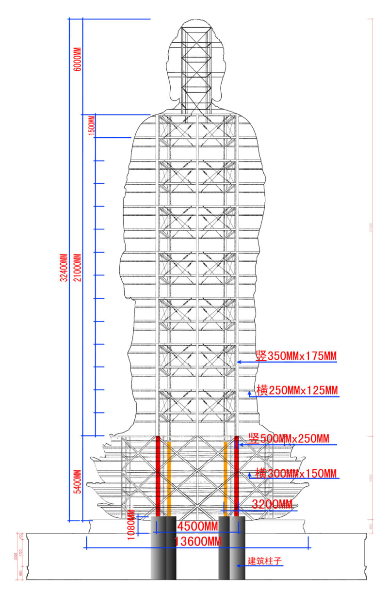

I'm working on the base support for a fairly large statue. It's 33m tall so roughly the equivalent of an elven story building.
The greatest trick that bond stress ever pulled was convincing the world it didn't exist.
RE: Tie the Buddha Down
Crap. Pushed submit before I was done somehow...
The statue superstructure will be designed by the statue supplier and will bear some resemblance to a transmission tower. The base that the statue will sit upon will be four concrete columns built integrally with a concrete shaft, somewhat like an elevator shaft. The columns and shaft will be constructed within an one story concrete bunker of sorts. Folks can go in there to perform various religious activities.
My questions are:
1) Is there anything special that we should consider in the design of the connection between the superstructure and the base? Fatigue? Should the anchor bolts be prestressed? Conceptually, this doesn't seem fundamentally different from a braced frame in any mid-rise building.
2) Our original contract excluded the design of the connection between the superstructure frame and the base. That was to be done by the statue supplier. I liked that arrangement because it put the responsibility for the connection with the party that I felt was best suited to design the connection. Recent events have led me to believe that I might be better suited to designing the connection. Any thoughts? Should I insist on doing the connection? Should I stand back from a liability perspective?

Neat... To be built in China? The markings look Chinese, but I thought this sort of icon was a no-no for the communist state.
By Chinese a company for somewhere else?
To be erected in Canada by a predominantly Vietnamese Buddhist congregation. Design and fabrication of the statue will be done jointly in Japan and China (good call on that). Copper and structural steel for the most part.
200 metric tones all in.

I see no interstitial horizontal diaphragms or cabled X-bracing as with the vertical planes. I doubt that the decorative skin can resist torsion...

Are the panel points in the picture purposefully avoided by the bracing rods? This can't be a seismic solution for a structure that is definitely NOT meant to deform under action/in service.
I echo Mike's concerns, and add the following:
- Who is responsible to separate/isolate/break dissimilar metal contact?
- Who is responsible for setting the wind and seismic loads?
- Who is responsible to allow for / design against the different coefficients of thermal expansion? I have a mental image of the skin just crumpling on a hot day...
More concerns are likely to follow. This is an interesting one Kootk! :jealous:

I'm content to let the statue designers sort out the details of their scope for now. Early days. I'm curious though Mike: why do you feel that horizontal bracing/diaphragms are necessary? I view the skeleton as just a big braced tube capable of resisting torsion sans diaphragm(s). There are some transmission towers near my house that are built this way (diaphragmless).

The budda is not a tube as soon as any of the material folds back upon itself... Which from the picture, it does. A lot.
Better to think about this as a stressed skin, like an aircraft. I do agree that the responsibility isn't your's on that point, but I stand by my questions. I hope your scope is *very* well spelled out.
The skin is not a competent structural tube but the structural steel tube within is. Or at least it's intended to be. Are you guys worried about horizontal bracing between the skin and structural steel tube? My expectation is that, when all is said and done, the outriggers with either be braced horizontally or made beefy enough that the don't require it.
All concerns regarding the design of the superstructure will be the responsibility of... the designer of the superstructure. Now how about some answers to my specific questions regarding the base connections?

Well... it is sketch... from China.

@IR: statue frame sits on shaft made from 300 walls and four 800 x 800 columns in corners. Shaft sits on monster pad footing. Ignore the base in the sketch.
So far, the only difference between this and a 6' statue is scale. As structural engineers, it's our prerogative not to be intimidated by scale.

Well, I don't see any structure to support the ears of the statue. I can't believe their structural engineers would not recognize such an oversight. In my experience, that is the first issue I would address. Have you contacted your client rep on this?
My recommendation would be to install a moment frame sideways to the main structure with a direct connection to the lobes of the ears. Simpson, et al, make pre-engineered moment frames that could tie the ears to the main structure. A moment frame would permit any required movement of the ears in extreme wind events yet retain them under major seismic forces. I see there is no public access to the ears of the statue which should shield your client from the inevitable litigation when swaying ear lobes throw someone to the floor.
Foundation? That's why most Buddha statues are sitting or lying down and have a big belly - it keeps them from falling over and thus they need no foundation, other than clearing people out of the way so the thing can be built.

@racooke: dissimilar metals issues will be an issue for the designer of the superstructure. By the time that it gets to me, it's just a plain old carbon steel to concrete base plate connection.
@CEL: know of a good reference for the debonded/prestressed method? I've got a few paragraphs in a PIP document but that's it. Debond it all? Prestress to the max? Provide an anchor plate and use standard anchorage checks? Transfer shear via friction?
@Ron: torsion is an issue but it is primarily an issue for the superstructure designer. And rest assured that I plan to devise a base capable of resisting the applied loads. And "applied loads" will mean those supplied by the superstructure designer and verified by me. Keen observation with the turnbuckles. The supporting shaft will have an access hatch up the middle for just that reason.
@Buggar: I hear 'ya. The ear lobes will be liquid filled mass tuned sloshing vibration dampers. No public access.

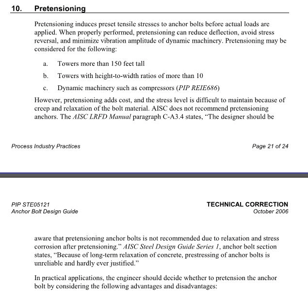

@Everybody: so we've got a concensus for prestressing. Why is that? If I told you this really was a braced frame for a mid-rise building and I was going with some good old F1554's, you wouldn't bat a collective eye. So what's so special here? And no, I was not able to maintain a straight face while typing that last bit.
What's different is a whole lot of things. Off the top I'd say:
- Lack of weight (as mentioned by others above).
- Lack of inspection/ease of access and maintenance (yes, I am assuming here).
- Lack of redundancy... This is not going to have the same number of connections as a midrise would.
- Lack of reliability/known conditions.
- Lots of "how the hell is all of this going to behave".
- Lots of secondary stresses (and potential for releases!) due to mixing of systems and materials.
- Lots of dubious workmanship.
- Lots of shrinkage (and potentially creep) in a mass foundation.

Thanks for the list CEL. I should point out that there is actually a significant amount of weight coming down on the support structure. The entire statue (~200 metric ton) is supported by the steel skeleton frame.
I intend to go with a prestressed AB connection for all the of reasons supplied by contributors above. My scepticism regarding pretensioned anchor bolts is, in part, informed by the excerpt from PIP STE05121, shown below. In an application where construction quality is a concern, reliance on prestressing seems like it would exacerbate the reliability problem rather than alleviate it.
