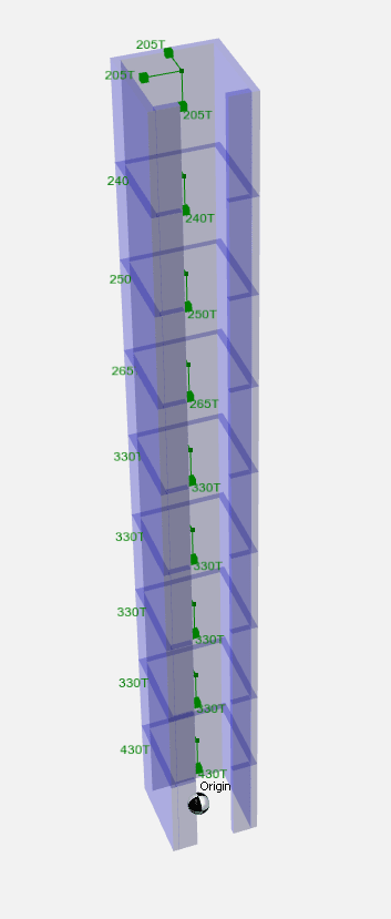

Am looking at some preliminary analysis for the lateral core of a 9 story building (relying purely on one core to do all the work). Also earthquake will dominate.
Would be great if somebody could point out any major flaws in my analysis method and/or make suggestions of their own:
> Using Spacegass
> Model core as pure cantilever with correct stiffness properties (can build up cross section in shapebuilder)
> Reduce the flexural rigidity of concrete E by 40% (to account for long term cracking etc)
> Place lumped masses at each floor equal to the seismic weight of each floor
> Have these lumped masses as transnational in XYZ, but no rotational interia because luckily the core is in close proximity to the center of mass of each floor.
> Then run a spectural analysis as per SpaceGass's tutorials.
> Review results for bending, shear and deflection.

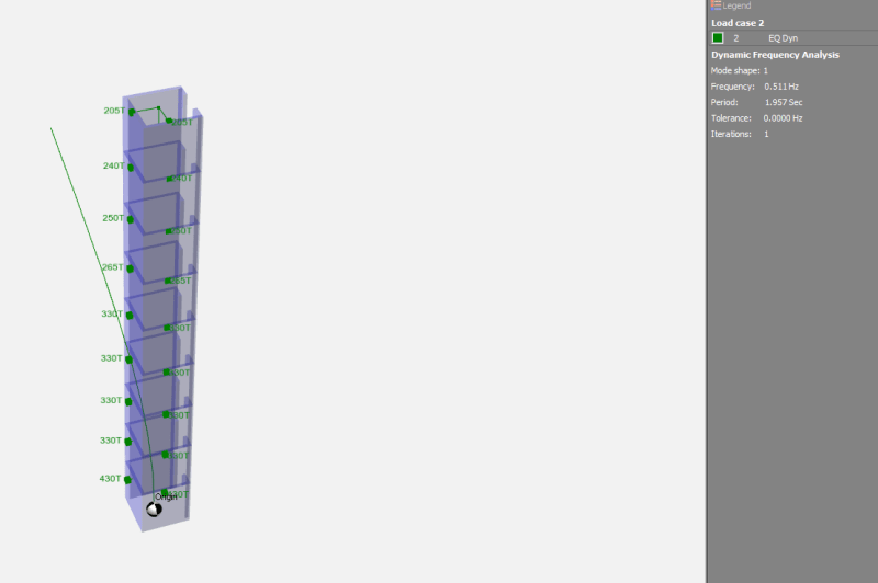

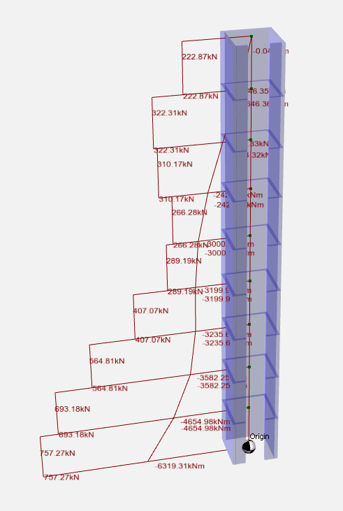

Problem is... the bending and shear that results from my spacegass analysis is much lower (40%) than my analysis by hand (equivalent static analysis AS1170.4).
However I understand the AS1170.4 method does not take into account the stiffness of your lateral resisting element (or does this well...)
Thoughts?

Modal response will result in lower base shears because the idealized stiffness of the building is used instead of the generic code equations. If you check the period from the code calc would probably be like 1 sec whereas the spacegass model is 1.9sec. It's less stiff, would be lower on that response curve and results in lower base shears.
Also the equivalent static calcs are based on a predominant first translational mode response (and an uperside down trianglular distribution of storey shears). As you go taller and become more flexible the higher modes contribute more, namely second mode so you can see that sort of kick back in the middle level storey shears.
Check your drifts and you need to check the inelastic drifts so they need to be scaled up by sp/mu.
AS1170.4 doesn't have a lower bound limit for minimum base shear but I like to use 2.5% of the building weight cause it was the old robustness minimum in AS1170.0. Anything less than this from a modal analysis I scale it up to the 2.5%.

Using the AS1170.4 equations, the fundamental period came out to be 0.751sec, which is obviously why it was attracting more load according to the generic equations.
