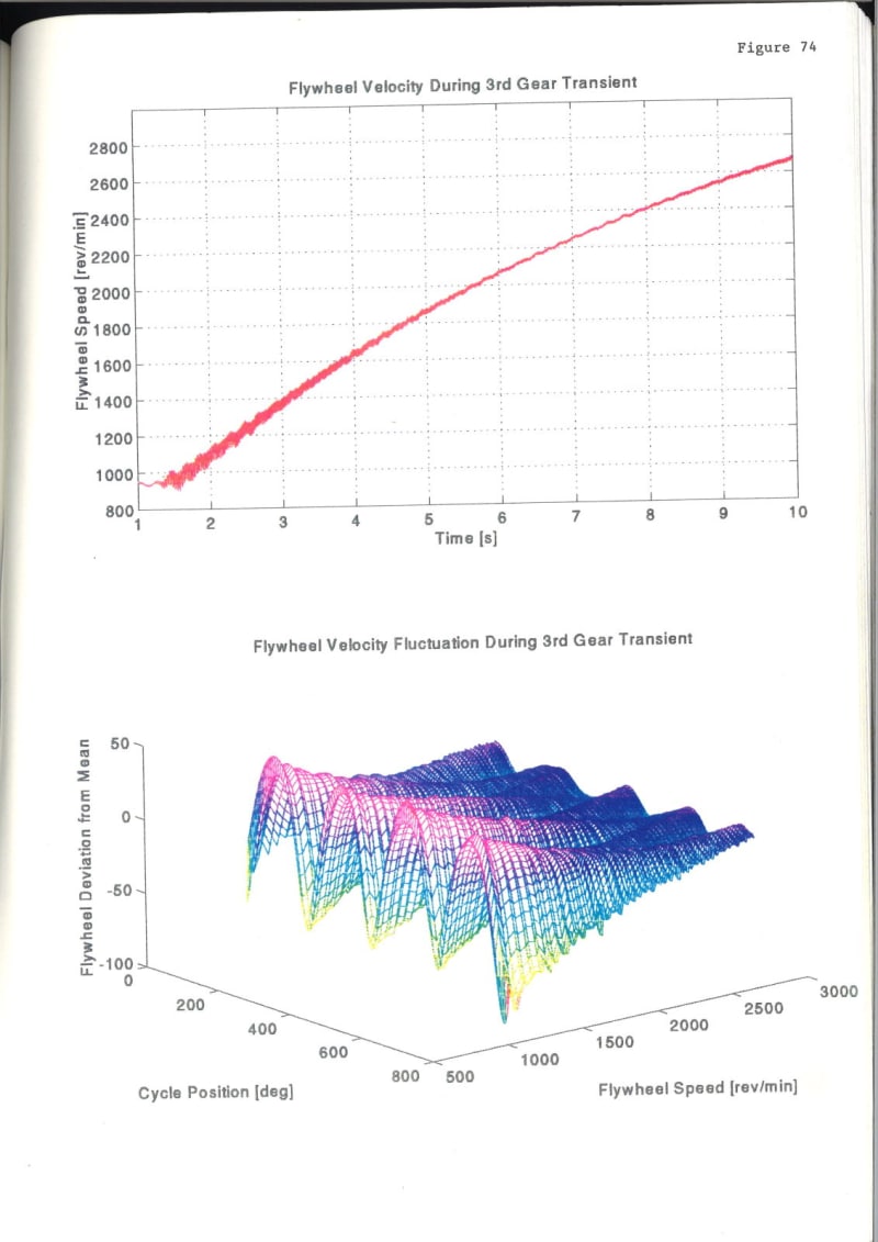

Here are some plots I did a long time ago (1994). They are from a simulation, but they matched the measurements very well. They both show flywheel speed during a full load slow transient (3rd gear) for a typical 1.8 I4 N/A gasoline in a 90's small hatchback.
The first is amplitude at given orders vs speed, where you can see 2E hitting a minimum.
The second is more interesting. It shows speed variation from mean through each engine cycle and (I think) you can see the 2E shape from gas forces decaying with speed as the 2E from inertia kind of rises out of the valleys. 2E is the dominant shape at each end, but there are two clearly unrelated sources.
You can see the point where the load goes on and also the shuffle it causes too, in the plots vs time. Nostalgia. I kind of miss those days. So much data to analyse. Matlab on hand to dig the story out of it.
- Steve

Very nice Steve!! thumbsup2
Seems to be dominated by 2nd order. I wonder how far the second plot's 2nd order slopes back up at sat 5000 rpm.
