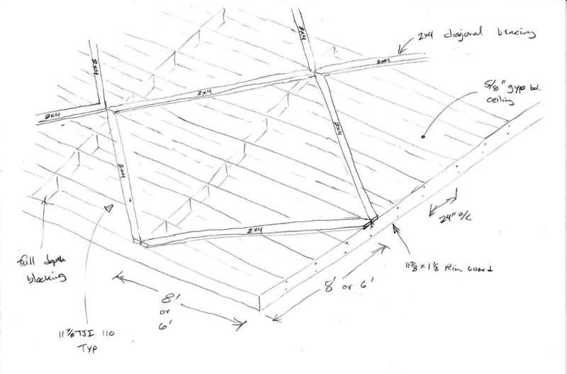

So here is an interesting question, one which I have never encountered before. I've got an existing steel building in which an occupant would like to frame up some internal partitions and internal ceiling inside (ie. 2x6 @ 16" o/c, 2x4 @ 16" o/c and TJI 110 @ 24" o/c), insulate etc... The steel buildings are quite tall so the one story wood framing would leave quite a large attic space above. In order to prevent the occupant from trying to turn this added space into additional storage the building dept. will not allow the top side of the ceiling /(internal) roof to be sheathed with 7/16 OSB. Granted this "internal" roof will never see any wind or snow loads, however the vertical dead and live roof loads and particularly the lateral seismic loads now become the governing factors.
The manufacturers specs on TJU's suggest lateral bracing approx. 4' o/c (ie. 2x4 running perp. to the ceiling joists) however this doesn't really constitute a diaphragm in my opinion. Some sort of diagonal lateral bracing combined with the perp. lateral bracing might get me a little closer.

As for possible bracing I was thinking something along these lines:
However, sheathing it with 7/16 OSB is the strongest and most sensible solution. This time I disagree with the bldg. officials but I see there point as well. I think the thing to do is to present a couple options and then let the bldg. dept. and the owner duke it out over the details.
RE: Diaphragm without Sheathing?
I was thinking 1x4 strapping at 4' o/c with intermittent 1x4 diagonal bracing at some generous interval. Depends on the LTB bracing requirements for the TJI.

I like the 4' o/c spacing for the laterals. Went back into the software for the TJI and the LTB bracing requirement varies between 5-1/2 feet to 3-1/2 feet so 4' o/c is about right. Then I'll specify a diagonal brace that runs every 8', so o/c spacing is approx. 4 x 1.41 = 5-1/2'. 1x4 seems adequate enough, no need to overkill it. Still not sure how to run any numbers on this and it probably doesn't even come close to the shear capacity of OSB sheathing but it does seem pretty substantial and better than just relying on the gyp. board for diaphragm action.
I wouldn't consider the topside bracing that we've been discussing the "diaphragm" from a seismic perspective. Just LTB restraint. If the drywall doesn't get the job done, I suppose that you could sheath the ceiling with OSB with the drywall below. That'll cost a few pennies though.

I was about to call this one "mission accomplished" but then I was looking at my seismic worksheet and noticed the response modification coefficient for gypsum as 2 and not the 6.5 for WSP. Table 12.2-1 of the ASCE 7-10 (item 17) simply states light frame wall with shear panels of other materials. Granted a diaphragm is not a shear wall in the strict definition but it does deal with shear loading in a similar manner. If so then my R should be 2 which significantly drives up my seismic lateral loads and I'm back to sheathing the ceiling with 7/16 OSB. Am I interpreting this wrong?
I guess I will throw in the towel on this one and go with GWB on top of OSB for the ceiling diaphragm. Reading some more online and digging through every resource I could find I can't really find anyone of the opinion that using GWB as a diaphragm materal is a good idea or recommended. I'm still not sure on the response modification coefficient but I'm not going to take the chance.

I've discarded the idea of a GWB diaphragm however the client is not happy that we now have to sheath the ceiling with OSB and then gypsum. The building dept. will not allow the sheathing on the top in order to prevent unwanted storage loads and a single story becoming a "two story structure". It's hard to win on this one, but rather safe than sorry.
However, my one still burning question is what is my appropriate response modification coefficient if I have WSP shearwalls yet a GWB diaphragm, am I still okay to use 6.5 or does it go to 2 because of the GWB involved?

I believe that the philosophy is for the diaphragm to remain elastic and the bulk of the energy dissipation to occur in the walls. That would lead me to believe that the correct technical answer is to base your force reduction on the wall construction. Of course, basing it on the drywall is conservative. And conservative in very tempting in exotic situations.

As the R relates to the vertical elements, I would use the R for the shearwall. So a WSP would have R=6.5.
