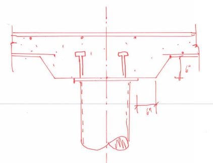

Assuming that you're not attempting to take slab moments into the pile, I would absolutely use Nelson studs. I'd also make the "cap" just a concrete thickening that extends maybe 6" below the floor slab. Lastly, I'd make that thickening at least 6" wider than the pile cap plate on all sides to account for tolerances. Unless I'm missing something regarding the function of the joint, what you've shown strikes me as considerable overkill.

The only load I'm intending on transferring into the pile is vertical and horizontal (wind/seismic).
RE: Pile Foundation Design
Then this may be an attractive alternative for you. It's probably better load transfer for wind and seismic. I should have drawn the cap plate embedded.
