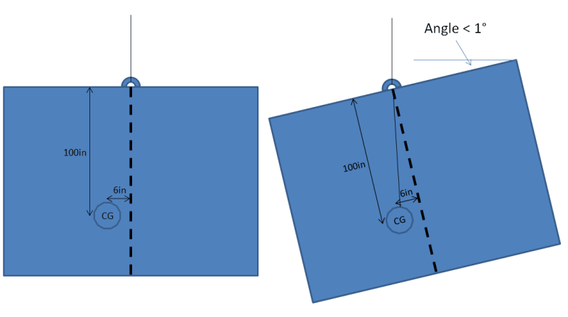

Let's say I have a large structure that weights 100k pounds that is hung from a simple support at the very center (x,y = 0,0). The CG is offset by a few inches, say (6,2). I need the structure to hang within 1 degree of flat.
This seems like a simple trig problem but I am unsure how to setup the equation(s). I can add counterweight to bring it into spec, but need to know how much weight and where to put them ahead of time.

if the structure is supported at the origin, and the CG is at some point (X,Y) then the structure will rotate under the CG is under the support ... tan(X/Y)

Maybe this sketch would help make things more clear:
RE: Balancing a mass within 1 degree?
I offer the same solution. Structure weight times 6 inches = counter balance weight times its distance from suspension vertical.
Pick counter balance weight = 1000lbs.
The counter balance weight must be located 100000*6/1000 = 600 inches from the suspension vertical to the right for perfect balance.
For 1deg out the cg is about 1.75 inches from the suspension vertical.
100000*1.75/1000 = 175 inches from suspension vertical for 1000lbs to balance offcenter cg.
Ted
My above final solution is incorrect. At 1 deg off level the cg will be about 4.24 inches from the vertical suspension line. The counter balance of 1000lbs will need to be 424 inches from the vertical, not 175 inches. At perfectly level, the angle of a line from the suspension point through the cg is 3.43deg(arc tan 6/100).

Neither the 100in or the 6in is known from the OP's test. All we have is an angle.
JHG
drawoh, I was using data from op's sketch above.
Ted
hydtools,
I don't think those are real numbers. The OP made them up to populate his sketch. If he knows X and Z as shown, I am not willing to explain his counterweights to him.

in the OP he assumed a CG position, and i think later posts suggests he knows where it is. I think we're all trying to tell him it's easy to figure out the rotation, tan(X/Y), like he shows in his sketch, 13 Nov 15:13, and from that is should be easy to figure out much much weight to put where to bring the CG to the 1deg line.
