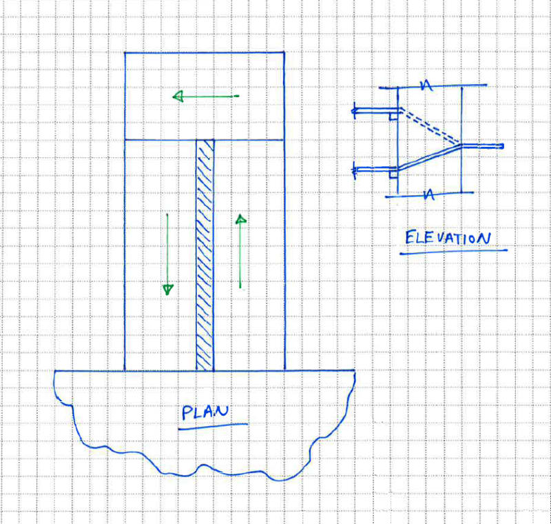

Reviewing some existing RC stair design and have stumbled upon something very similar as shown below.
What is the design philosophy behind this? Does it work as a triple cantilever (from each face of adjoining wall)? Pinned or Moment connection to the wall?

It is a messy analysis, so let's go to extremes, then see what approximations are probably 'good enough" In other words, in the real world, is the result "right enough" to be safe for people?
Assume that central "wall" were strong enough so it does not deflect significantly.

Just a clarification - there is only one single central wall supporting both flights of the stair.
RE: Floating Stairs
I was thinking that the two stair flights can possibly cantilever out to pick up the mid height landing.
Thus in the region of wall where both landing and flights meet, the reo/ferrules would need to be designed to take the weight of the flight plus the weight of the it's share of landing.
Summary: two propped cantilevering flights and a single span landing.

Keeping it simple, I say it is a single blade/spine RC wall (adequately connected to the building floor slabs) and the stair treads cantilever off the spine wall, and the mid-landing cantilevers off the adjacent treads, pretty much as you state.
Rather than just use the stair 'throat' as a structural thickness, you can use the full riser depth (less cover) for the stair sections off the wall. The midlanding will use its slab thickness.

For your particular case, the question du jour is whether or not the stair treads are cantilevered from the central wall. You should be able to tell us based on the framing detail at the wall in your existing plans. If your sketch is entirely accurate, I expect that you're spot on with your triple cantilever notion.
Nowadays, I'll usually do this without the wall. Architects love it and it's usually entirely doable with good diaphragm connections and perhaps a torsion beam where the mid-landing meets the flights.
When the wall is present, cantilevering the treads from the wall is mechanically appealing and certainly possible. It's not usually what I see done however. More commonly, I see the wall treated as a point support at the mid landing and ignored elsewhere. This can be done by:
1) Running the wall into the mid landing a bit.
2) Having a corbel project from the wall under the mid landing.
3) Providing a shear friction connection between the end of the wall and the landing slab.
Some reasons for not cantilevering the treads include:
1) Contractors like the simpler detailing that results.
2) With normal stair spans, it's quite doable.
3) You can use a nominal 6" wall.
4) The analysis is simple. The flights span to, and cantilever past, a beam element running perpendicular to the wall where it meets the landing. The beam may or may not be contained within the slab thickness. As you've rightly pointed out above, the shear delivered by the landing needs to be dealt with via connection to the wall end over a relatively short distance. This method makes that demand very explicit.

The landing cantilevers off the flights, but the flights don't need to cantilever off the spine wall. They can be pin support on the wall. The flights can't rotate anywhere with the slab and landing restraining them.
Of course, it's probably worth making them rigid connections to the wall anyway, as it's not really any harder, and this appears to be the general engineering judgment from the profession from what I've seen.

"4) The analysis is simple. The flights span to, and cantilever past, a beam element running perpendicular to the wall where it meets the landing. The beam may or may not be contained within the slab thickness. As you've rightly pointed out above, the shear delivered by the landing needs to be dealt with via connection to the wall end over a relatively short distance. This method makes that demand very explicit."
How do you handle the unbalanced loads in your analysis either due to geometry or due to occupancy? Do these unbalanced loads put a twisting force into your wall or do you end up with axial loads in flight of stairs?
RE: Floating Stairs
Axial. Never turn down a free lunch. It's never perfect due to little mini landings at the tops and bottoms of the flights. That's minor stuff though.

KootK, I know you love sketches...
What do you think of mine?

But do my sketches make sense? Analysis wise?
RE: Floating Stairs
The first seem unnecessary but harmless. I see the landing as a one way design element. That one way being parallel to the flight.
The second sketch is spot on.
For the third sketch, I would have shown both halves of the beam and had it pinned at the centre instead of fixed. There's nothing wrong with fixing to the wall so long as you follow the design through consistent with that.
