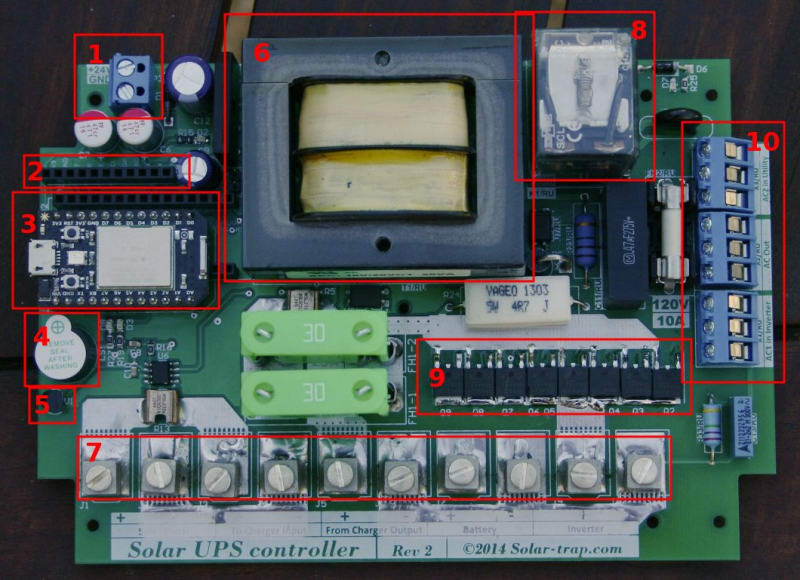

It has been almost 6 months now and I ended up using a shunt to measure current instead of the hall sensor. I re-designed the entire board and have attached a pic of the current PCB layout for reference.
I am having a Kickstarter campaign running since Monday now so wish me luck to get this project off the ground :)
Markus
RE: How to properly measure currents with hall sensors
Thanks for the update!
You have what looks like a well thought out layout there. I see you went with a Maxim shunt amp.
I assume it did the the trick for you.
Good luck on your KStarter project.
