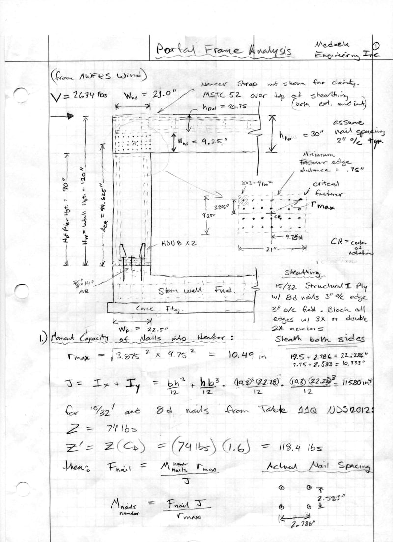

Here is a proposed portal frame, I'm not saying its correct but I'm going to run the numbers on it to see what if anything is wrong with it:
RE: Portal Frames and Nailed Moment Connections
The start of the calcs shown below:

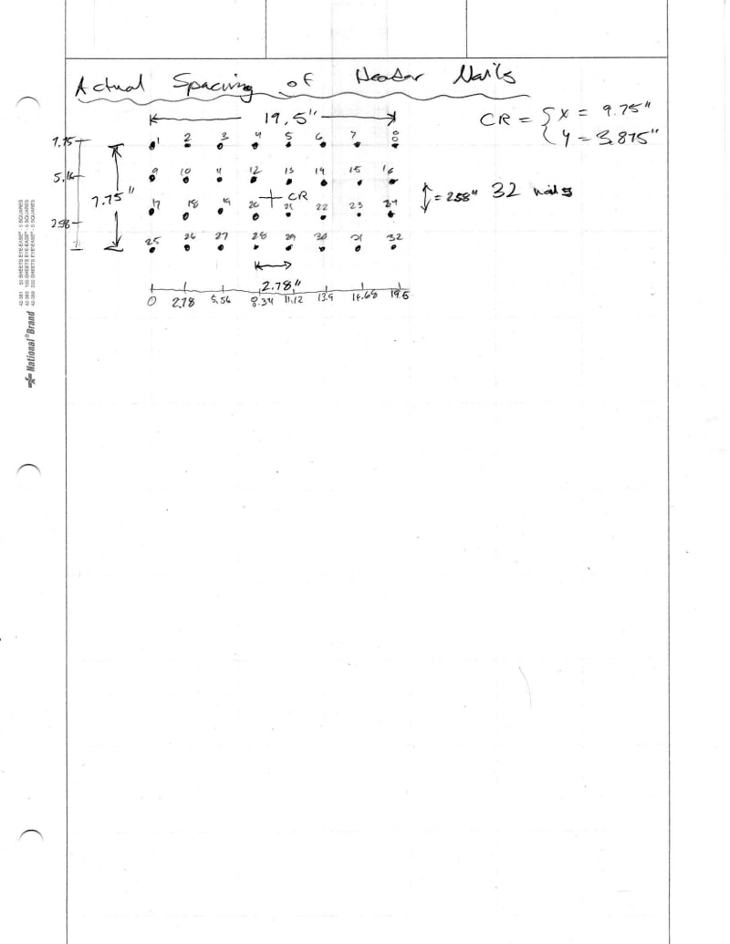

However, I didn't trust the number I was getting for the total moment of the fasteners from the elastic method so I created a spreadsheet which calculates the moment contribution of each fasteners and then sums them up:

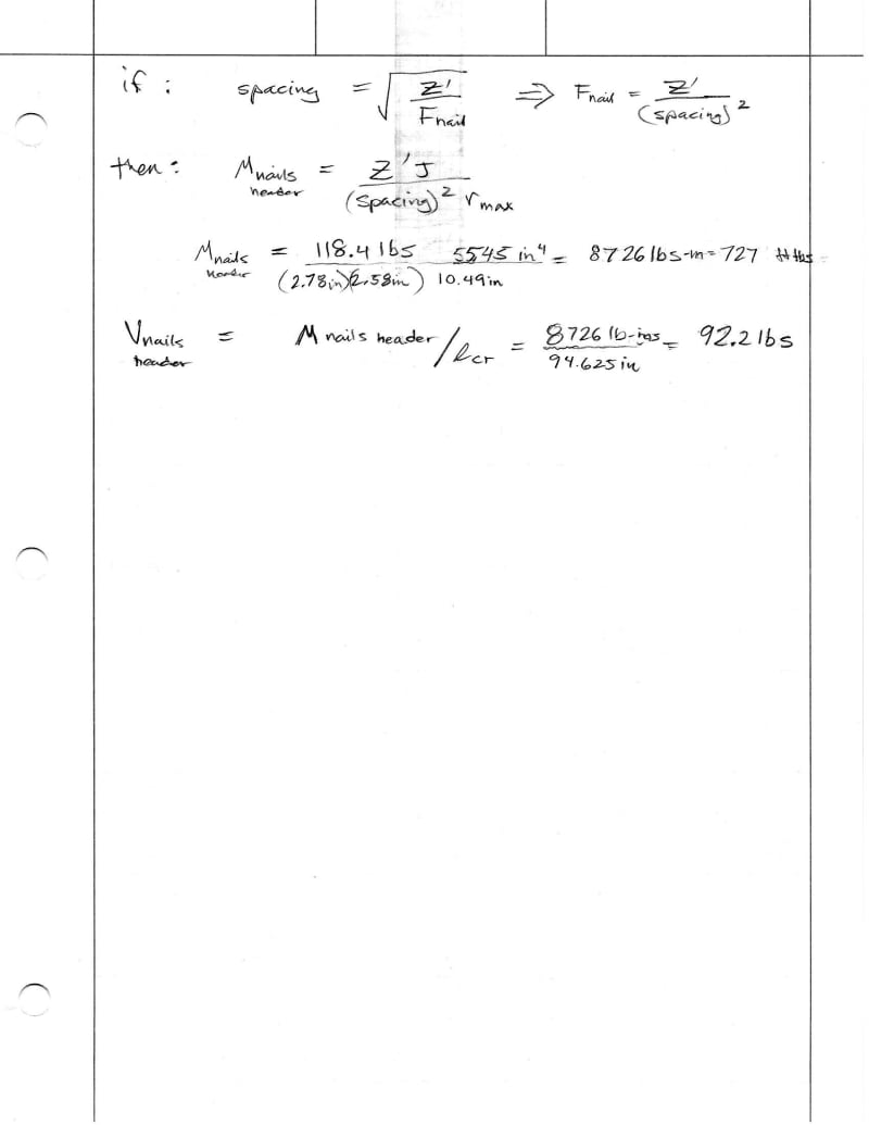

The problem I am having is the two numbers for the total moment capacity of the nails don't agree and I haven't been able to get them to agree. Maybe someone can tell me what is wrong with my calculations in particular the equation M(nails header) = Z'J/(spacing)2rmax.
My feeling is the correct answer is the 17,724 in-lbs given in the spreadsheet, correct me if I'm wrong.

I made a few adjustments to the numbers I was using for the calculation of the polar moment of inertia and now I get M(nails header) = 18160 in-lbs which is within about 2.5% of my spreadsheet answer, close enough.
Then the V(nails header) = 2 X M/lcr = 383.8 lbs since both sides are sheathed.
Note that this value is conservative since I am ignoring the contribution of the nails into the sheathing above the header (into the pony wall), actually probably too conservative for some. This value is only taking into account the nails that are nailed in a grid pattern into the header.
I could theoretically include all of the nails that are in the panel above the header and to the side however the calculation of the center of rotation would become quite complex and I think a conservative approach is warranted where the quality control in the field might be somewhat suspect.

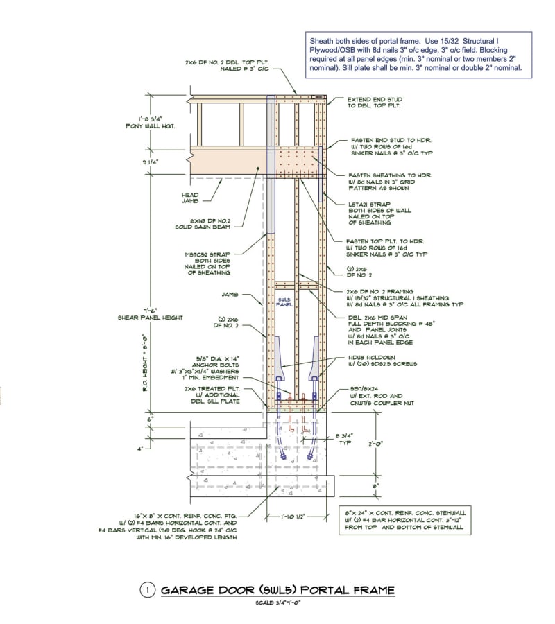

Here are the final calcs for the shear capacity of the portal frame. Note that in this case the governing factor appears to be the the sheathing-to-framing connection based on nominal unit shear from SPDWS 2008.
You will notice when looking at the Autocad drawing above that I have a MSTC52 strap on one side of the portal frame and a LSTA21 strap on the other side (approx. 1000 lbs capacity). The idea here is that the single 2x6 king stud to the top of the portal frame takes most of the load when this side of the portal frame is in tension thereby eliminating the need for a large strap on this side of the PF. If you look at the current PFH portal frame with holdowns in the IBC or IRC you will notice that this strap is conspicuously missing, previous editions of the IBC/IRC seemed to have had this strap in their diagrams.
The tensile capacity of a DF No. 2 2x6 is fairly decent especially with a CD of 1.6 applied for wind / seismic loads. However, my engineering mentor pointed out to me that the nails connecting this king stud to the rest of the framing and sheathing will probably fail in shear before the member will actually fail. So then my thought was to just increase the strap on this side to equal the strap on the other side of the portal frame (ie. MSTC52 strap on both sides, interior and exterior, 4 straps total). However, if you look at this the outside strap would mostly be nailed into perimeter king stud and most of its developed strength would rely on this king stud shouldering the tensile load. In other words even with a larger strap the point of failure would still be the nails shearing that connect this king stud to the rest of the portal frame (header, framing and sheathing).
Perhaps I am over thinking this.

I think that your points are valid. But then I tend towards over thinking myself. My thoughts:
1) Where does the outer strap deliver its tension load to in the end? To the header? To the outermost stud? I would have expected the path for that portion of the of the tension load to extend right to the top of the portal frame. You could make it do that easily enough by extending the strap over the cripples above.
2) You've got a metal strap and a wood stud working in parallel to resist a common tension load. There may be some issues with stiffness compatibility. Suppose the stud absorbs all of the load initially and snaps, then sheds its load to the strap which then yields or fractures. Or vice verse. I'm not clear how much ductility can be relied upon in this kind of system. This probably is over thought as we seem to disregard such issues in wood construction routinely.

So what would be the best option for the outer strap on the portal frame? If you remove it entirely then you are relying on the bending strength of the sheathing or moment capacity of the fasteners plus the tensile capacity of the end king stud which is probably governed by fastener shear into the adjacent framing.
To address item #1, I'd run the strap up to engage the blocking above the header.
To address item #2, I'd take all of the load across the strap.
To be honest, I'm not sure that anything needs to be changed so long as you've addressed your load paths thoroughly, As I mentioned above, it's not clear to me where the outer strap tension ends up at the end of the day. It appears to deliver its load into the header.
Certainly, if the outer king stud and it's connections can deal with the entire tension load, I think that it's fine to leave it at that.
