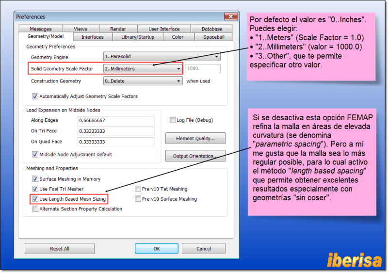

First at all it seems to me that you have a big problem with the setup of FEMAP: you mentio to prescribe an enforded displacement of 40 mm but .... the length of the block is only 2.362 mm!!. Then, something is not reasonable here!!. Go to FILE > PREFERENCES > GEOMETRY and make sure you the option SOLID GEOMETRY SCALE FACTOR = mm, it seems to me that is set to INCHES!!. Also check the rest of items.

I note you have updated the geometry scale factor to import the geometry in mm (not in inches, like before), good!. But still more things are "incoherent", for instance:
• The material properties are in PSI, not in MPa, this is because the material library you are using (by default, the file "material.esp") is in inches, pounds, ºF, etc.. Take a look to my website to learn how to configure FEMAP Preferences, this is the initial setup to be done in any FEMAP installation: http://www.iberisa.com/soporte/femap/femap_tips_tr...
