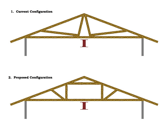

Hey all, hope you can give me some advice here. First, I'll start out by saying that I've got a pretty good background in woodworking and am not too bad with "common sense" structural work. That said, I need some professional incite here before moving forward with a repair. I've got a detached garage, with approximately a 6-12 pitch, that's developing a sagging roof. I don't know the actual dimensions but I'll try to give you an idea of the footprint. The garage itself is an offset 1-car garage but is easily wide enough for 2 vehicles to be side by side (non-vehicle side is a workshop area). With my tailgate lowered, the depth of the garage is just barely enough for my truck to fit in.
In my unprofessional opinion the sagging roof problem is due to a bad fink truss design that leaves far too much of the roof unsupported (see #1 in attached image). I've actually found several of the near-horizontal web trusses detached from the roof joists and hanging in mid air. I temporarily put them back into place, but it's obvious this truss design is not made for Northern climates and I want to remedy the situation before the snow falls.
Unfortunately I don't have much cash to spend, so doing an entire roof replacement isn't an option. That said, I've got a whole stack of new 2x4's, and joiner plates, sitting around and doing nothing. I'm wondering about the feasibility of, one by one, "rebuilding" the trusses to give me better attic access and at the same time more strength in the sagging areas of the roof (see #2 in attached image). The load of the roof is supported by the outside walls as well as a very heavy steel I-Beam that runs down the center of the garage, so I think this new design should be stronger than what's currently there. From what I can tell, the truss splice joints are all down the center, over the I-Beam, so that shouldn't be an issue either.
Just wondering if any structural engineers out there could give me a thumbs up, and if not then field some suggestions.

The second truss is a terrible idea. The middle sections of attic trusses are really no trusses at all. Rather, they're more like vierendeel panels that place large shear and bending demands on the chords. That's why, on real attic trusses, it's common to see 2x8/2x10 chords and heavy plating.
Do engage a structural engineer.

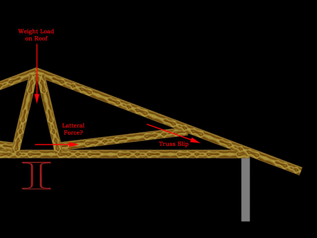

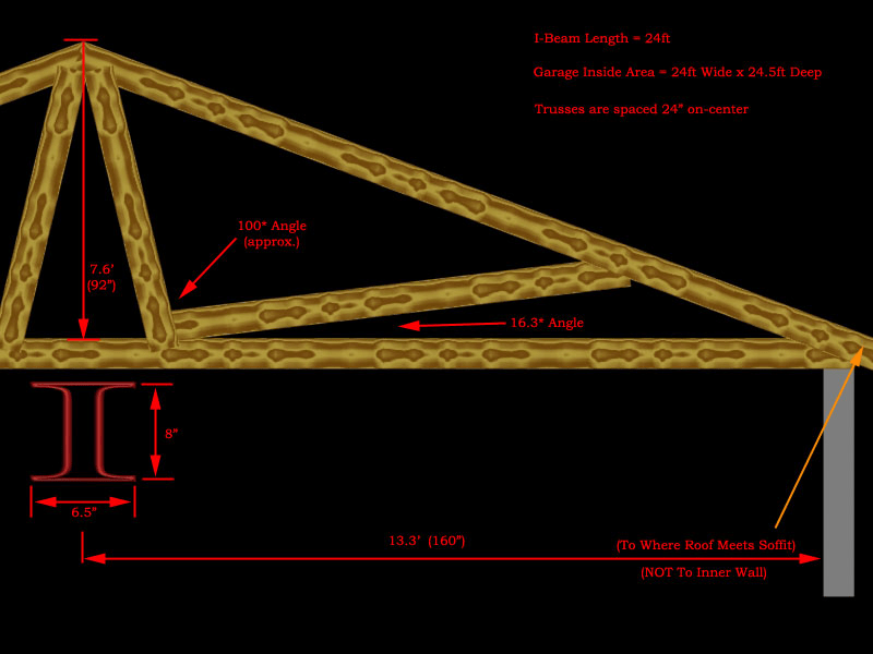

Ok, this should help out all you structural folks. Sorry I didn't have pictures earlier, wasn't at home to take them so a graphic was the best I could do.
In this first image you can see (hopefully) the sag in the roof. The peaks on either end are better supported so they're act the actual height the entire roof used to be at. The sag is heaviest in the center, almost making a U shape from end to end.
This next image shows the span and angles of the truss webbing. I've also highlighted the I-Beam that runs from the front of the garage to the rear of the garage. As the trusses rest directly on this beam I'm assuming it's carrying some of the roof load.

RE: Truss Redesign due to Sagging Roof
Is the steel I beam you mention big? Is it supported by a column on each end? It's not obvious to me that it was intended to support the roof....
Thanks for the photos OP. No ridge beam required. Some blocking would be nice but that's not high on the fix-it priority list.

So, I had a talk with a relative (roofing contractor) who agrees that going with the "attic" design will probably cause more problems than it solves. That said, he noted that solving my problem could be as easy as adding a 3rd member to my already existing truss web. It would extend from the bottom web connection upwards and divide the large open area in half, like so...
Thoughts on this??
It's better than what you have now, but I still wonder just how mych the low angle diagonals are contributing to the truss here.

The latest idea certainly won't hurt anything SaultGuy78. And, if top chord sag is an issue, it'll probably help. However, the side view photo of your garage indicated sag along the ridge line. Tht indicates sag of the trusses as a whole, not just top chord sag. I'd look for:
1) Connection slip in the heel joints.
2) Connection slip at the bottom chord splice connection if there is one.
2) Sideways bowing out of your eave walls at the tops.
The greatest trick that bond stress ever pulled was convincing the world it didn't exist.
I would place the additional diagonals halfway between the ridge and the wall line.

The pictures scream homemade truss to me, and not by someone who really knew what they were doing. Just someone who thought they did.
How long is the center steel beam spanning, and how deep is the beam?

I had a little time today so I went up and took some measurements. I know my "graphic" isn't to proper scale or design but I've used it anyway and filled in some blanks that people seemed to be needing. I hope it helps more.
