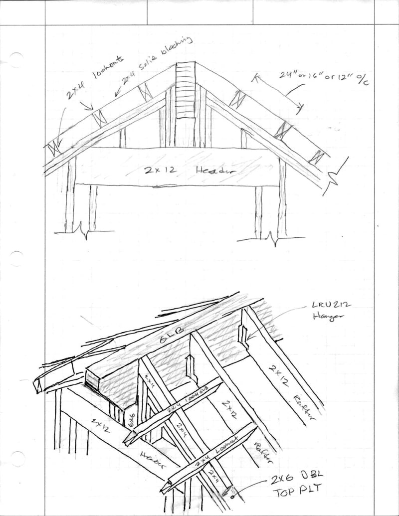

I've got a wall of windows on a gable end with possibly two methods of framing it (so far). Can anyone tell me what is wrong with the first picture? Note that 22 ft. of roof is tributary to to the glulam beam at the ridge (actually only half of that 11 ft is tributary to the gable wall). The load is the S + D, the dead load is approximately 50% of the total load.
RE: Wall of Windows
With the first picture, the 5.125 X 12 glulam will probably fail in wind weak axis bending. lateral deflection will be a lot more too.
I much prefer the second option with the two full height columns taken to the roof diaphragm.

Option one lacks post continuity from foundation to roof diaphragm. You'd either need a monster girt at eave hight or you'd have to count on the specified strapping to moment connect the posts across the girt. Using the straps in this way would make me particularly nervous as the substantial load from the ridge girder will tend to promote stability problems.

I made it too easy, I shouldn't have posted the wind load information on the first sketch.
With the 189 plf load on the glulam beam in its weak direction, neglecting any straps that may counteract this lateral load, even sistered with two 2x6 (top and bottom) I get the following:
fb = 4500 psi > Fby' = 2530 psi (CSI = 1.78) ======> NG
Also if the beam doesn't snap it will deflect 15.2 inches. Granted the wall may act as a web to some degree and resist this lateral deflection but I wouldn't count on it.
Then you take the vertical loads which will only make matters worse (hinging effect).
Hence Rev. 2 of the design... and I need to explain to the architect/designer why his wall of windows won't work.

Could you run the two 6x6 posts through continuously, and get rid of everything else other than the eave hight girt and the shear walls?

My biggest concern with option #1 (besides the obvious deflection issues with the Glulam) would be the connection at the two shear walls.
The load coming out of both ends of the Glulam would be in the range of 4,000+ lbf - not your average wind load.
A quick glance at your Second drawing (much better design in my opinion) gives me concern about the 2x12 rafters.
Tall gable end walls always need special concern for the lateral support at the roof decking.
I would frame the wall full height to the roof decking and attach a 2x4 or 2x6 ladder spanning at least 24" (your first roof truss / rafter past the wall), possibly 48" depending)
The Ladder framing runs at 12" OC. perpendicular to the wall with:
-nails to the roof decking to transfer lateral load to the diaphragm
-nails to the double top plates to transfer load to the ladder framing
-this allows you to cant out for overhang as well
See the attachment for a similar design I have done - pay attention to the lower right hand for the ladder framing detail

I see where you are going with this Signious. The 2x12 on edge will want to topple over without some blocking running perpendicular to the rafter.
How about something like this:
If more strength is needed put another 2x4 block in line with the outlooker to the next rafter (and strap tying the two together).

This will require a nailer on the inside wall for the ceiling sheetrock. Also the straps connecting the 2x12 Header (HD1) to the DBL top plate will require some additional blocking if the strap is on the inside (block as required).

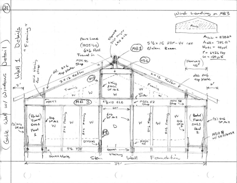

The change in the posts shrunk my shearwalls slightly as well as increased the height. At 514 plf I'm going to sheath the interior and exterior of both shear panels and even though my allowable is 670 plf, and probably a little conservative, I welcome the additional margin of safety.

Here is the basis geometry drawn up:
RE: Wall of Windows
So I met with my mentor today and apparently there is a pretty significant flaw with the design drawn above. The two center posts really need to tie directly to the double top plate otherwise the out of plane bending load (wind) is going to cause problems at the post/header interface. The problem is I am trying to maintain approximately 6 inches between the window and the door so there is no additional room for more trimmers. My only other option I can see is to make these two columns continuous to the top plate and then hanger the top header (HD1) off of the 4x6 columns (P1). I was kind of hoping for a good solid wood-on-wood bearing so having to resort to hangers at this point feels like a cop-out but maybe that the direction I have to take with this.
RE: Wall of Windows
Also after re-checking the numbers on a longer column height, now 15 feet instead of approx. 13.5" I decided that the posts on both sides of the door need to be something more substantial, so 3-1/2" x 5-1/4" Versa-Lam 1.7 2650 PSL.

I just checked the deflection on the P1 columns and I have a L/d of 106, looks like in this case the deflection is the limiting factor and not the stress. Looks like I'll have to go with deeper posts (ie. 3-1/2 x 7-1/4) however that brings up the debate whether to leave the wall at 2x6 and have the posts bumping out or bring the whole wall to 2x8 so the wall is smooth.
RE: Wall of Windows
Even with the IBC .7 reduction (.42 C&C) from footnotes of section 1604.3 I still get a deflection of 1.56" => L/d = 116 which is too much. I'm really starting to dislike tall walls at this point.
RE: Wall of Windows
3-1/2" x 7" PSL Column => L/d = 267, Deflection .67 inches. That works. Note that I am using the C&C zone 4 for these calcs per the general direction given in the ilevel document above and also being that this framing is in the center of the wall and actually is in zone 4. I'm beginning to think that using zone 5 would be over conservative in most cases with regards to stud walls etc...
RE: Wall of Windows
The updated detail:
