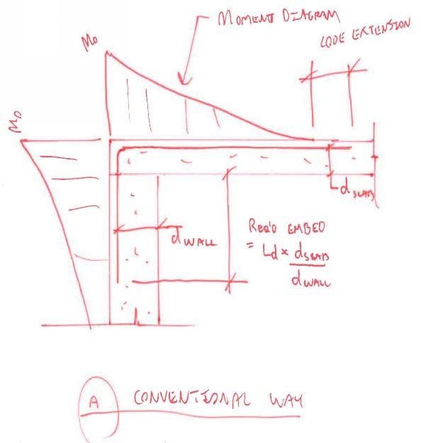

Are we talking about dowels that are embedded into the wall and then bent horizontally into the slab to deal with negative moment? If you're relying on negative flexure at that location, then you're not out of the woods yet. Any moment assumed to be present in the slab at the joint will also be present in the wall. And that means that your tensile connection is very important.
Below, I've sketched two versions of how this ought to be done. The first is the conventional way that most designers approach this. The second is the way that I think it ought to be. For what it's worth, most designers that I know will model this joint as pinned and only provide top steel for crack control. The reason is primarily quality control. Wet set = kinda bad; field bending = kinda bad; dowels getting run over by forklifts = kinda bad. All tolled... bad.

@kootk: What an excellent response. I agree in general, but would point out a few things. First, I'll sweep all of this into the realm of "theoretical discussion" by mentioning that this is a slab on grade, with no real moment... it's just over-designed (designed for settlement?). Second, I cant really go around presuming that they haven't taken the wall vs slab depth difference into account due to my unique roll in the situation. The EoR asked for thus and such an extension length of the bar along the top of the slab, and the contractor screwed up... I was asked, as the third party owners rep, to document fixes and propose solutions. I can tell them that they have an available tensile lap capacity of X based on the break strength of the concrete and the existing lap length, but I cant really (read: "don't want to") tell the EoR that they have way too much strength called out, and that they should calm down. I assume that they will take the contractor to task to some extent anyway, to make a point about not screwing up.

Well, thanks for being patient with me asabender. I totally misconstrued your situation. I should have picked up, by your mention of curling, that we were talking about SOG.
