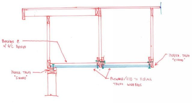

I have a dream for solving Medeek's very issue. It's a dream that will never come true but, what the heck, here she is:

KootK, Love the horizontal truss idea. I would think you could probably get it to work as a 22 1/2" deep truss that would fit in the first truss space. This would remove the requirement of an odd truss as the second last one.
RE: Garage Door Headers
KootK, this would also give some outstanding anchor points for multiple garage door opener brackets. Those tend to just be anchored to any 'ole truss. Mine is a 'hard ceiling' garage, so the sheetrock is transferring the stress to the adjacent trusses!
The oddball truss is certainly what keeps the dream from ever becoming reality. And garage door support would definitely count as a pro. Would this be more "saleable"?
Diaphragm aspect ratio limits would apply to the plywood solution but not the truss solution, right?

For the window opening, I have checked out of plane and even axial when missing the top plate. I've also included straps to transfer the force.
For the gable wall situation A few thoughts.
1. I do like the truss idea and I've used something similar.
2. I see kickers up to the rafters many times which isn't bad but almost always calcs out to overstress the rafter.
3. Usually the ceiling is drywalled so you have a diaphragm and also there is some sort of stiff back bracing the bottom chords which 'ties' together the opposite gables and distributes the load.
4. I'm sure the wall acts as a plate elements when fully sheathed.
