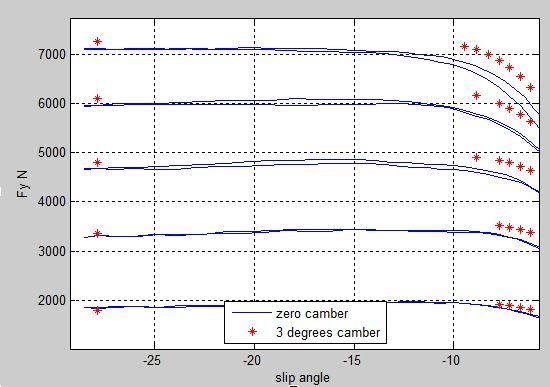

Greg:
I didn't find much info on camber sensitivity with a quick Google search. Can you suggest sources?
Jay
Jay Maechtlen
http://www.laserpubs.com/techcomm
RE: Question regarding Roll Centers of a Double A-Arm suspensions
Open sources for complete sweeps of tire force and moment data are few and far between, you might have more luck finding Pacejka coefficients and reconstructing the curves.
Cheers
Greg Locock

"I'd work back from the desired tire inclination angles "
Hi Greg,
Is that more than actual tire on road camber, and can you share what angle modern widish street tires might prefer?
thanks
Dan T
Yes, we know the tire needs to be roughly square to the road, or leaning into the turn a little at the top. How much would depend on the exact tire, I don't know, but 3 degrees doesn't seem to be dangerously outside of a reasonable figure.
shows raw F&M data for a tire at various Fzs, with 0 and 3 degrees of inclination angle.
Cheers
