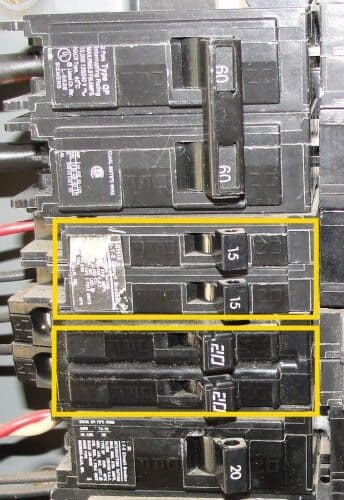

I've got a circuit in my home that is incomprehensible (to me at least). From a new 15A breaker (installed a couple of months ago), the wire goes to a plug in the hall bathroom, to a wall plug in the master bathroom, then to a GFCI plug next to my wife's sink, and finally to a plug next to my sink. Four duplex wall outlets. Two of the holes have night lights in them. The electrician verified that those four plugs were all that was on that breaker (no Dr. Evil heat sinks or anything).
Two to three times a year my wife yells at me that her hair dryer doesn't work. Before we replaced the breaker, I would go to the breaker box and turn it from tripped to off, and back to on. Circuit still dead. Wait about an hour and turn the breaker off and back on and all the plugs are live.
I thought there was something in the breaker that was causing the problem and in spite of the electrician telling me that there is no way it was bad, I had him replace it. Today it did it again except the breaker was not tripped. Neither was the GFCI (which I replaced before I had the breaker replaced). I opened the panel and the breaker shows 122V to common when closed and zero when open. I finally gave up and went to do other stuff. About an hour later I cycled the breaker and all the circuits were live.
It acts like it has to cool off for a while before it will start working again. Anyone have any ideas?

There is a thermal cut-off switch in hair dryers that will reset when it cools down. Perhaps you are making the mistake of using the hair dryer as the power-on indicator for the circuit. Hair dryers will trip-off due to the inlet screens getting partly plugged with hair and lint.
Circuit breakers are also thermal devices and need to cool to reset. It should not take that long though. Check the temperature of the breaker when it trips. A poor connection to the bus bar will cause heating. Heat from an adjacent breaker could also be the cause. GFCI problems can be difficult to find. The trip indicators sometimes do not indicate. Use the test and reset buttons to make sure the breaker is working properly.
RE: Weird Home Electricity
Probably a wiring problem. A recording meter would be good tool, see what the current was doing prior to the trip and when it started doing it. An ammeter with a max capture that you could leave on the circuit for awhile would be useful. Even just a regular old ammeter could give some clues - what's the current in the circuit with just the two night lights?
If closing the breaker put 122V to neutral on the load side, the breakers is closed and good. Your hour is waiting for the wiring trouble to cool off and reestablish contact. What ever your problem is, there are far worse ways for it to manifest itself than the repeated tripping of a breaker, like the breaker not tripping. Sounds like a nontrivial problem that should be addressed as soon as practicable.

Any chance of a nail or drywall screw partially (and intermittently) puncturing the cable somewhere along the run?
The history and age of the house, along with any renovations, would be an indicator of likelihood.
If the bus bar extension had a bad connection to the bus or to the original breaker there will be heat damage. That will result in the breaker tripping on the thermal trip. It will have to cool down before resetting.
I would pull the breaker and check for heat damage on the bus and/or the bus extension.

When we replaced the breaker we checked carefully for any signs of heating and couldn't find any (I had the breaker on my desk for several months and had everyone who came to my office that had any electrical expertise look at it and no one could find signs of heating).
The house is about 20 years old, and there hasn't been any major renovation in 6 years.
Since the wiring goes from the breaker box to a plug in the hall bathroom (about 15 ft) and then to the master bath (another 60 ft), I'm wondering if that receptacle might be the problem (it seems that if the problem was after the hall bath, the plug in the hall bath would still be live). Does that make sense? I think I'll replace it and see if the problem goes away.

I think I've read both of those. If both are true the problem is entirely in the wiring beyond that breaker lug.

Had a similar problem in my home, turned out the neutral loosened at the bus bar in the breaker box and would intermittently lose contact. Had a devil of a time figuring it out, but a tweak on the screw solved the problem. It's been good for several years now.
The problem is not the breaker. But, I would be concerned that the breaker is tripping on a circuit with apparently little load. That is indicating that something is shorting and the shorting and possible arcing could eventually lead to a fire.
Is the electrician 100% certain those are the only 4 loads? This needs to be verified 100%. Once the complete circuit is known then I'd start at the breaker panel and work towards the far end checking the circuit for issues. If a problem can't be found in the breaker or outlet boxes then I'd consider hi-pot or megger testing the wiring to try and find a problem in the walls.
The problem definitely was not the breaker, but the old breaker had its own problem (tripped on the bench at 5A instead of allowing 15A to pass). The new breaker did not trip contemporaneously with the latest power outage. I don't know about 100%, but the electrician was pretty certain that there were only 4 plugs on the circuit. When we re-did the master bath a few years ago he wired #2, #3, and #4 (they moved locations in the remodel), and when he checked at the time he was confident that the only thing left on the circuit was #1.
I will check all the neutral lugs in the box. Intuitively, I can't see how this could be the issue, but my intuition is pretty weak in this stuff.

Duplex 15A breaker, As in 2-poles? It makes no sense to have that type of breaker on a 120V circuit with 4 outlets like you are describing.
The problem is still that the power gets lost at all the receptacles with the breaker on, right? If yes, there has to be a problem with the wiring between the breaker and the first receptacle.
Interesting that the two breakers are side by side, as in some wiring the breakers on the X side of the 220V will share a neutral with the Y side of the 220V. Not for the whole circuit, but part of it.
Just a thought that maybe there is an issue with the neutral on the shared section of the of the two circuits.
I obviously used the wrong terminology. It looks like the breakers circled in yellow (maybe the right term is "tandem"?)
Half size breakers. Tandem have one handle behind the other.
The half size or tandem breakers allowed a manufacturer to increase the rating of some lines of panel boards.
At one time, a major manufacturer used the same bus bars or strips in all panels up to 200 Amp rated panels.
However under the Canadian Electrical Code, not only the rating of the bus bars but also the number of breaker spaces are used to determine the maximum rating of a single dwelling panel board.
I always get the rules screwed up for when and how many half-sized breakers can be used, so I just prefer to stay away from them altogether.
