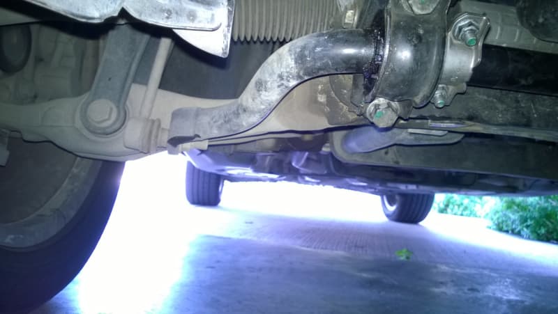

I recently purchased a Mercedes ML350 (W164) and as usual I started to see how to tweak the handling and was very surprised with what I saw. Attached are pictures of the Sway bar and the bushing used to connect the sway bar to the body. How would this sway bar work? In all my other vehicles, the sway bar would be able to swing freely in the bushings, but in this case the bushing is clamped to the sway bar, and then the bushing is clamped to the body. How does this even work?
RE: How does this suspension work?
Here are the images
It's hard to say with great confidence from the pictures, but i'm thinking the clean steel clamp that grabs the bar extends axially and has the rubber element bonded to it. The relative motion between bar and large main clamp is meant to be handled by rubber-in-shear (no lube required), not by the rubber sliding either in the clamp or on the bar.
The grease suggests the rubber tore loose and someone tried to quiet a squeak with lube.
That is what I was thinking too. Like an engine rubber mount. Which also means that the sway bar is not relaying the roll motion to the other side as it is restricted/terminated at the clamp, as if the middle section of the bar did not even exist.
looks pretty normal to me - each end of the bar is linked to moving parts of the suspension, and it rotates in bushings mounted to the frame or chassis.
Looks like those clamps just keep the bar from sliding side-to-side in the bushings.
What part of this do you consider mysterious or unusual?

Oh-you're referring to the bushing design?
Well, does the car move in jounce? Then you can be sure that the bar turns.
What exactly happens in a factory bushing when it is in good condition? I guess the rubber shears (deforms).
Does the service literature say anything about the replacement procedure for the bushing, or if it should be lubed?

The rubber shears (deforms torsionally) to allow the antiroll bar to rotate. Most suspension bushings are like that nowadays.

This is the first one I have seen like this. Interestingly, if I were to replace these bushings, would I be replacing them with the vehicle up on the lift or on the ground? In others words, would this need to be preloaded? In conventional sway bar bushings, I'd replace them with the vehicle on the ground, but since this design appears to defy that conventional design, I am questioning the whole concept.
The bush is soft enough in torsion that it does not terminate the torsional loads in the bar. It does, of course, contribute to the springing of the car, and basically acts in parallel to the road springs. The reasons for using this design are several, the primary one being that it eliminates the sliding joint between the bar and bush, which is a cause of squeaks. The lubrication of that interface is not satisfactory over long periods of time, even with fancy oil retaining liners.

Normally when you replace that type of bushing, you do whatever you need to do to change the parts with the vehicle up on a lift except you leave the clamp bolts (#350 in the diagram) loose until you have the weight of the car on its wheels so that the suspension is compressed to nominal ride height - with the bolts loose, the bushing will find the place that it wants to be - then you tighten the bolts with the suspension loaded.
I'll just about guarantee that this is not the first time you've seen this design, you just might not have recognized it before. Most shock-absorber eye mountings are rubber-in-shear, also. That's why you're not supposed to tighten the bolts until the car is sitting on its wheels at nominal ride height.

Jay, Greg, Brian - thanks for the information.
Interesting, if you delve a bit deeper, you can see this design should provide an infinite/analog amount of preload(add to spring rate) depending upon how high the car was WHEN you tighten the bushing to the rod & clamp - right from nominal load when the vehicle is on the ground on its own weight to when it is high up in the air on a lift.
I will try out various settings during the week and see which one provides the best ride and control. Stay tuned.
You do not want to do that. You want the rubber to be at (or near) no load at normal static ride height. If you set it otherwise, it will shorten the life of the bushing. It's not meant to be used as a ride-height adjuster.

After some trials during the week, I have found some things that are very interesting.
1. How do you ensure a 4632 lbs. SUV handles quick and tight?
2. How do you get a soft smooth supple ride while attaining #1?
3. how do ensure that the sway bar does not slide around?
4. How do you get a sway bar work like a bigger bar without using a bigger one?
The answer is BIG BAR SOFT SPRING SET UP + some Mercedes ingenuity.
In order to get the bar act like a bigger one than it really is, it has to be preloaded. One of the test I did was to loosen the bar and tighten it when the vehicle is on the ground, and it drove horrible because the soft springs on their own are not capable of carrying the weight of the vehicle. The optimum setting I discovered was raising the vehicle by 2 inches and then tightening the sway bar and bushings. When I dropped the vehicle back to the ground, the ride height was still the same, but the sway bar was now preloaded and contributing as a spring.
At this setting, it takes turns like a sports tuned vehicle, and when on the highway I cannot even feel the road cracks and joints. In addition, the confidence grows as I go faster and faster as it becomes extremely stable which is the highlight of the BBSS setup.

#1.Everything is stock here - Springs, shock, swaybar and bushings.
What I was attempting to do is understand how Mercedes Benz designed this front suspension. All said and done, whether I preload or not, the ride height is still the same. But the swaybar us now preloaded by the twist lock action.

Now, I may see this wrong, but from what I gather, you may have a "secondary" effect at play here.
I don't think, that you actually "preload" your anti roll / sway bar with what you do, but you may get a effect, which feels like "having a bigger bar", and from your comments, there seems to be a perceivable change in handling, so something is "going on".
My 2 cents, is that is that by "preloading" the rubber bushings, you end up with a much "stiffer" bushing in radial direction.
This in turn could mean, that your anti roll /sway bar now actually has to "twist" and work as a it is intented to work.
If you tigthen the bolts with the car on the ground, and have little/no prelaod on the bushings, then , seeing that the bar seems to be quite "stiff" it may becomes easier for the whole assembly to move up and down in the rubber bushings, then to actually "twist" the ARB/sway bar in roll (during cornering).
To understand/picture better what I mean, consider what would happen if you take one of the mountigs of the ARB completely off.
The ARB wouldn't twist the free and would just move up (or down), the ARB trying to stay parallel with the road, while the body would roll.
With the "none preloaded" rubber bushings, you could get a similar effect, the whole assembly will follow " the path of least resistance".
The ARB would first "tilt" in relation to the body, trying to stay parallel with the road and avoiding to be twisted (work like a ARB), if the deflection in the rubber bushings come to an end, the bar will start to twist (work like a ARB).
Now by "preloading" the bushings, the bar cannot longer (or much less) "tilt", and will start twisting sooner/more, providing a larger force to oppose the roll moment (reducing the roll angle), and doing so much sooner, what you may feel like a "sharper" handling.
The "extreme" case, to take this further, would be to replace the rubber mounts by nylon bushings, in this case, you would "force" the ARB to twist right from the beginning --> no secondary/parasitic "tilting" movement w.r.t. the body.
Now, I dunno what MB "intented" to be the "correct" setup,but I would agree with what Brian said.
If the system isn't "designed" to work like this, you may "overstress" your bushings in shear, and will limit their life span.
At one point you may get a "shear failure", the bushing cracking/rupture between the inner and outer clamp/ring and reducing the preloed/stress after a while.
This would be especially the case, if you use your car "off road", and make use of all the suspension travel on a regular basis.
