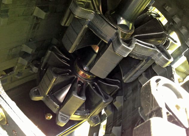

RE: Need drive sprocket design help
Are you sure your track does not require the type of cylindrical surface features shown adjacent to the sprocket teeth in this picture?
These cylindrical surfaces are not contiguous but they still force the track to follow a path around the sprocket that is very close to circumferential. Without them the track follows a path around the sprocket similar to what you would see in a conventional roller chain.
Tbuelna, I haven't seen a sprocket quite like that but this is why I believe they are making that sprocket that way. Snowmobiles drive the track in one of two ways. In addition to running a regular sprocket like what we are all used to, the inside of the track also have lugs (you can see them in the pic)that extend down off the inside surface of the track as well. Many machines use a sprocket with recesses that engage these lugs, basically a negative image of a sprocket.
The ones that drive the track in a "normal" way with a toothed sprocket are called no slip sprockets, because apparently when the track starts to get worn it will begin to ratchet over the negative type sprocket and slip. I believe what you have a picture of is a hybrid dual drive sprocket that runs the track using the windows and the lugs.
I have attached a photo below of an external type snowmobile sprocket that does not have the extra appurtenance on the sides. I really think I have made the tooth profile to fat at the top and it just is not able to get into the window correctly.
