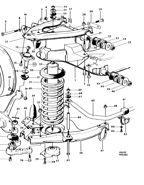

A recent thread runs something like this - There is danger of using Grade 5 instead of Grade 8 bolts on the upper A-arm rods............ Both alignment shops that worked on the poster's car insisted on installing Grade 8 bolts in place of the perfectly good Grade 5 bolts that were installed. One of the new bolts broke as he was going over a speed bump at less than walking speed. Now, the front end is making groaning and popping noises. He feels Nothing’s broken yet, but plans to replace the bolts today.
My guess is they may be discussing item 29 here -

There is danger of using Grade 8 instead of Grade 5 bolts on the upper A-arm rods.
Also I would really like to see what came installed from the OEM, in regards Grade and coatings. I may be able to find the size and torque spec in a manual.
RE: Grade 8 vs Grade 5 bolts in under car suspension service
The bolts used to attach the upper A-arm shaft to the frame are not likely highly stressed. So a Gr.5 bolt should work fine if that is what it was originally designed to use. However, I can't see where using a higher TS Gr.8 bolt would create a problem, unless this bolt is installed using a torque-to-yield technique.
