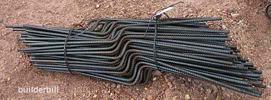

Does any body else have trouble getting detailers to provide rebar clear covers, etc. on their placement drawings? If so, does anyone have a "scary" CA note that they find useful to place on the shop dwg review pdfs? This is one of the most annoying peeves of mine. Devil's advocate: Maybe it shouldn't be?

It *is* in the structural drawings, but I do not view the CD's as placement drawings for rebar. I just could never envision a worker locating piece marks on the rebar drawings and then flipping to the CD's to find clear cover requirements.
RE: Concrete Rebar Shop Drawings
Jay...when is the last time you've seen a rod buster with a set of structural drawings in their hand? I honestly don't think I ever have. Placing drawings should be a stand alone set of drawings for placing rebar. This thinking follows ACI and CRSI recommendations also, I believe.

who ever said that steel reinforcement "shop" drawings were "placement" drawings? they are done by the fabricator for use in fabricating the steel in the shop, not for forming or placing it. In order to get the bar lengths correct, the required cover does need to be considered, but not necessarily shown on the shops. the contractor had better have the CD's on the job site...
Most Rebar shops I see have a nice big fat note that says they are not stand alone drawings, or placement drawings. They are to be used in conjunction with the structural drawings.

dhenger - acronyms are not the issue here. And, no need to extrapolate my use of "CA" in the thread to my drawings - I do not use abbreviations on my drawings unless they are defined on the drawings. My specs specifically require rebar shop drawings to indicate bar cover, among all else. No matter how many notes or spec lines call my requirement out, I always get resistance - sometimes I get tired of prolonging the shop dwg process and accept them anyways, with the hope they will use the CD's in conjunction.
cvg: I do in my specifications.
Are you telling me that piece marks are not used in the field for placing bend bar? What *are* the placement drawings, then? Some combination of the detailer's and Cd's?
These are the bundles of bars they are going to get in the field with tags on them indicating the piece marks, right? What drawings do they absolutely need to place these bars...the detailing drawings with the piece marks on them, hence placement drawings. If the bundles didn't have the piece marks they would be wasting time measuring the pieces and correlating them with the CD's. I just don't see how else this could be properly performed.

I will add a note regarding cover to the shops. Before the first slab pour, I make sure that I am out there. Before they start laying the rebar, I tell them that I need to see 3 things:
* The bar orientation must match the plan (inner / outer layer)
* The rebar cover is correct 3/4" on top, more is not better
* I want to talk to the rebar inspector to make sure that he has both a set of structural drawings and approved shop drawings. I tell him / her to check both and call me with questions.
More often than not, the top rebar cover on elevated slabs is way too low.

Part B of the ACI 315-99 *seems* clear to me that one of the detailer's responsibilities is bar placement drawings. I wonder how many detailers accept that as true.
The definition of "rebar shops" and "placing drawings" is different in different parts of the country. As an industry, we are working to improve placing drawings. I am hopeful that we will eventually manage to get full placement information, uniformly, on the placing drawings, but this will probably require better checking by the structural and contractor communities. ACI 301 will implement a few changes in the 2014 edition, and CRSI is also working to help define what is provided and used by the fabricators and placers. Obviously, the goal is to assure that the design is properly constructed.

I have found some rebar detailers who DO indicate the cover requirements - but it's not consistent and may vary from detailer to detailer.
IMHO rebar drawings are intended to serve 3 distinct and separate purposes:
#1 - Demonstrate the detailer's interpretation of the contract drawings with respect to bar sizes, arrangement, splices, etc.
#2 - Determine the bar quantities, dimensions and bend details for their fabrication.
#3 - Provide the means by which the installer can identify which bar goes where.
The engineer of record is obligated to confirm #1 in his/her review of the rebar drawings.
The fabricator is obligated to cut/bend bars in accordance with #2.
The installer is obligated to install the bars in accordance with BOTH the contract drawings and the rebar drawings. Realistically, the latter should carry more weight as changes are often made in the review process that will never be reflected in updated contract drawings.
