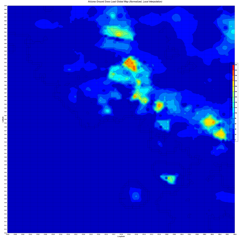

Here are some surface plots of the Normalized Ground Snow Loads using the 3 and 4 point interpolation algorithm of the online map:
http://design.medeek.com/resources/snow/images/ARI...
The top image is the entire state of Arizona, with interpolated data points every 0.05 degrees (approximately 3.5 miles). The script actually chugged through it even though there were 14,400 data points to calculate. I'm currently using Chartdirector as my surface plotting software. Does anyone have any suggestions on an alternate plotting software. I need something that can handle lots of data points and has a lot of controls for tweaking the cubic spline of the surface plot.

couple issues I see. it appears that the app both under and over estimates snow loads and in addition in at least one case reports the incorrect agency having jurisdiction.
Flagstaff city hall
App suggests a ground load of 82 psf and says the AHJ is Coconino county community development. this is incorrect, the city of flagstaff would be the correct AHJ, not the county. in addition, according to Coconino county, the ground load for areas surrounding Flagstaff would be 40 plus an additional 15 for a total of 55 psf. The load reported by your interpolation routine is considerably higher than that.
Showlow
Showlow is underestimated. the application says 27 psf and the code requires at least 40 - 45 psf roof snow load. same with Snowflake which requires 30 - 35 roof snow load but the application only indicates 15 psf.
Safford
underestimated, the app says zero snow load but the code requires 50 psf ground load
Mt Graham, one of the highest mountains - elevation is over 10,000 feet and the app predicts a snow load of just 5.5 psf. your interpolation / data set is inadequate for this area.

Like I said the interpolation needs some fine tuning. Probably another months worth of work here at least.

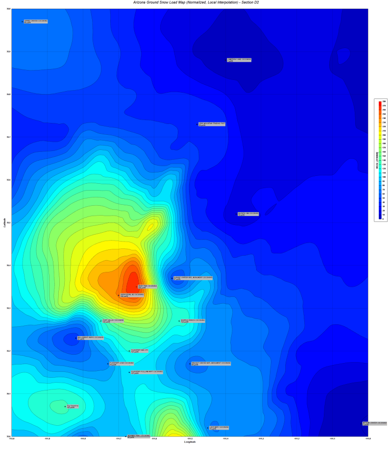

I've now superimposed the actual Climate Stations with their NGSL into the contours maps. I've created 36 blocks since the script takes to long to run reasonably.
Take a look at block D2:
Normalized Map with Data Points
Some weird artifacts going on their North of Bear Paw. At least now with the mapping software in place I can tweak up the interpolation and then easily run a check on what it is doing overall and check for anomalies and areas where it has difficulty or is breaking down.
Note, that the ground snow loads reported will not necessarily coincide with any particular jurisdiction's code that is why I am appending some of this detail below the computed values, for comparison and engineering judgement. Obviously it would be nice if everything matched perfectly but I don't think that will happen, not unless there are some manual exceptions placed into the dataset, which might be the direction to take.
Thank-you for pointing out these issues CVG, they have been duly noted and will help me to further improve the algorithm.

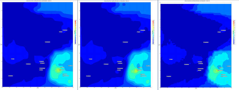

If you look at the following image some interesting things can be observed:
The first image (left) was at a interpolation spacing of 0.05 deg., the middle image was the same resolution however the actual station data points were included in the surface plot dataset, the third image was at a interpolation spacing of 0.02 deg and station data points were not included in the surface dataset (same as image one).
You will notice that next to the highest peak in this block is a station with a lower value. This seemed to be glossed over in the first image/surface plot. In the second image the nearness of these two points affects the plot quite dramatically. The third image seems to pick it up best and not over exaggerate the difference.
However, the third plot is showing some jaggedness due to the higher resolution of the dataset, the surfacing spline appears to have some trouble here.
The conclusion to be drawn is that where station points are dramatically different in close proximity a higher resolution of sampling is needed otherwise the 0.05 deg resolution appears to be working fine. Also I think it would be useful to include the actual station values in the surface dataset but this may present problems in certain areas.

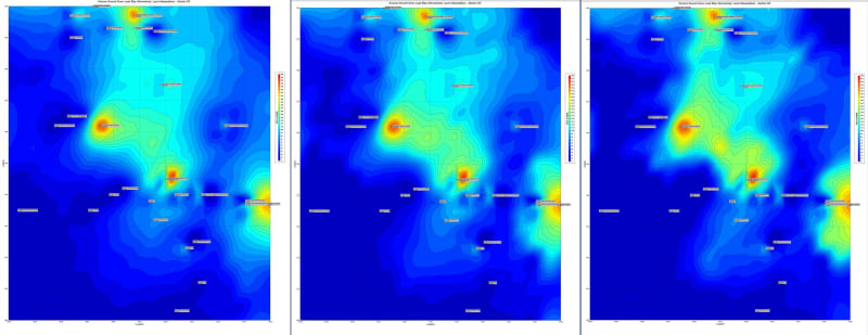

Another interesting comparison:
From left to right: 10 point interpolation, 6 point interpolation, 3/4 point interpolation.
As expected the more data points used in the interpolation the more averaged out the result. I've determined that the inverse squared IDW method seems to give me the best result so all three of these methods use that algorithm.
The next thing to possibly consider is selecting the data points not based on distance from the point of interest only but also considering the concept of how these points surround the point of interest (Delaunay Triangulation). If we consider three point interpolation (three nearest neighbors) then the point should fall within the triangle formed by these points and also we should select that triangle of points such that they are "well formed".
Possibly even the average of the 6 point IDW interpolation with a three point Delaunay Triangle IDW interpolation, with the ability to weight the average one way or other based on some sort of criteria.
