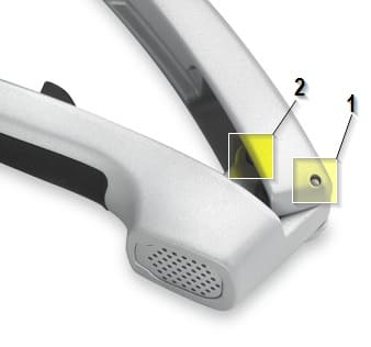

Let's talk about garlic presses. They have one pivot point - rivet which absorbs all the leverage in order for ram to squeeze garlic:
According to your statement, whether "part 1" is made of zinc or stainless steel does not matter because what matters is design?

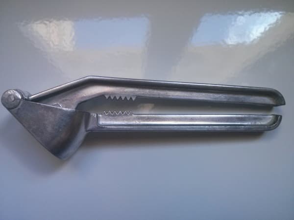

By the way, here is a picture of garlic press I have and I think it is fully made of zinc. Am I right?

Regarding part 1, it does matter what the part is made with. Either zinc or stainless steel can be made to work if several factors are controlled (material composition, microstructure, geometry, etc.).
Your press does appear to be all zinc.
