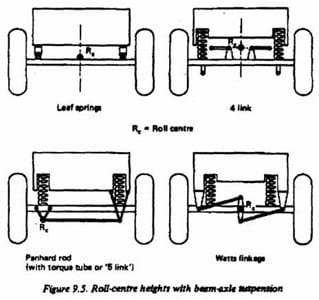

RE: roll center location vs camber gain's effect on haNdliNg
Let me try a simplification here. Roll center height determines how much a vehicle will roll in a turn. Camber gain keeps the wheels cambered (tilted) correctly relative to the road surface as the vehicle goes through this rolling motion. A high roll center reduces the tendency for the chassis to roll and thus lessens the need for camber gain. There are other issues related to high vs. low roll centers and control arm linkage design to lessen camber loss on chassis roll, and these can introduce new factors affecting handling. But one thing at a time. And remember, the amount of roll has no effect on weight transfer from inside to outside wheels on a curve. Only the track width and height of center of gravity affect this weight transfer.
I think the center of gravity height controls weight transfer, not the roll center (moment center) height.
Greg,
I stand corrected. There is a weight transfer attributable to body roll/roll center height. In the building design world we call this P-delta effect. If you have a very high center of gravity, body roll will allow this center of gravity to shift laterally, like a leaning building, and add to the weight transfer. Interestingly, this is a static weight shift induced by the dynamics of centrifugal force.
In most cars today this weight shift is low enough to be ignored in most literature.
Quote (BUGGAR)
I just want to to point the poor choice of words to make sure everything is clear: Weight transfer is attributable to centrifugal force only; nothing else. The suspension design has no effect on the weight transfer magnitude, only its distribution between front and rear axles.
If you have no suspension (like a go-kart), the chassis acts like a rigid beam and weight transfer distribution is basically a static problem with one load and two supports. If the supports are springs, the load is centered and we assume the beam cannot lean, then the stronger spring will take more of the load than the soft one. It is easy to visualize when we assume one spring has an infinite stiffness and the other has zero stiffness, it is easy to see that the load will be entirely supported by the strong spring.
But a suspension is combination of springs and rigid links, which both can react to weight transfer. The roll center measure the importance of one compare to the other. If the roll center is at ground level, the weight transfer distribution is entirely directed by the springs; If it is at CG level, it is entirely directed by the chassis and suspension links (the suspension links are «locked» with the chassis from the point of view of the centrifugal force). Anything in between is a mix of both.
But since most suspension designs aim at having the roll center near the ground, it can be safe to assume that weight transfer distribution is only affected by springs. As shown in the next figure, the exception are cars with a beam axle, which are extremely difficult to design with a roll center near the ground (hence the comment of Greg talking about a «typical large RWD sedan»)
Quote (BUGGAR)
See if the attached makes sense.
I see your point. The CG goes towards the outside wheel, increasing the weight transfer. I stand corrected as well.
Quote (Buggar)
Good discussion. See if the attached makes sense.
Bob
The sketch does make sense, but it needs to be shown with a more realistic amount of roll. Drawn closer to 4.5° than 45° would provide a better sense of the magnitude of actual CG migration being relatively small.
Norm,
You've never followed an overloaded mini-pickup in TJ?
Actually I was trying to figure this out late at night and used the principle of exaggeration to make it clear.
