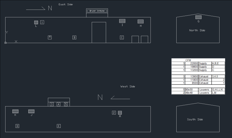

We are working on improving the ventilation to our factory. Our current dryer runs at a constant 45,000 cfm when it is running. I was looking at ducting this into our factory to act as 2 exhaust fans. Being a food grade plant, we maintain positive pressure of roughly .2" wg, to maintain this, we would be adding at the minimum 45,000 cfm of intake fans. My concerns on doing this is the exhaust fan is capable of 20" wg. To prevent this motor from sucking in our walls, I would be adding a pressure sensor to the factory to monitor the pressure. This would kick the dryer fan off if too much vacuum is sensed within the factory. To prevent the operators from running this fan in 'hand' mode, I would wire in a keyed switch to the MCC bucket. I would think I'd want to connect up the new intake fans to VFD's such that they ramp up with the dryer to maintain our pressure, also controlled by the pressure sensor. My other thought would be to wire each intake fan up to a different pressure sensor for redundancy sake.
Thoughts / Comments?

Currently, there is no ducting in the factory. We have several large intake fans near the ground, and several exhaust fans located near the ceiling to duct heat out of the factory. These aren't enough, so we are looking at adding additional intake and exhaust fans.
The dryer pulls air from outside, and rejects it back outside through an exhaust stack.
I'm not concerned about the CFM on the dryer, if anything, it should be higher due to the small amount of positive pressure within the factory.
Just trying to see if anyone has tried this before, or if I'm overlooking any other important details.
Overview of current layout

@mintjuliep - We already have the fans as shown on the CAD drawing, they are a long ways from being enough, which is why we are adding more. I understand the KISS principle, but at the same time, it seems like such a waste to have a 45,000 cfm exhaust fan constantly running that is pulling air in from outside, as well as multiple exhaust fans pulling out the same volume.
@bronyraur - That's exactly the rationale behind this. The airflow in this plant is horrid, the plant is packed with hot equipment. My hope is that with a big centrally located exhaust inlet, we would have a lot more flow covering the plant instead of just blowing around near the walls, with a small amount escaping through the penthouse (that's what we call the top extension bit).

One question to ask if it hasn't already, is whether the dryer's intake can be modified to pull air in from the factory floor. If it can, would it void any warranties assuming it is still under warranty. If you do add ductwork, the fan now has to overocme the additional friction lossess associated with the new ductwork; from the fan curve, you don't have a lot of room to work with without sacrificing air flow. Which raises the question of can the dryer do it's job with less than 45,000 cfm of air? Contacting the dryer's manufacturer is recommended to ensure it can be modified to do what you want it to.
You mention adding several heat intensive processes. Where are these relative to your dryer? If they are not close to the dryer (lots of new ductowrk) or there is workspace between these new processes and the dryer, having ventilation air moving over these processes towards the dryer is not going to solve your worker comfort problem since you are now heating this ventilation air and your workers with your new processes. The work spaces between the new processes and dryer will likely be warmer than outside (not desirable for south Florida).
I think you would be better off leaving the dryer as is, adding the new supply fans as intended (probably do not need 45,000 cfm of new) and add exhaust fans or gravity vents in the roof above the new heat generating processes. Intent being to direct air heated by the new processes away from your workers and their work areas.
Not knowing exactly what you are producing or how interrelated the drying process is with the new process, keeping the dryer's ventilation separate from the rest of the building allows you take it out of service (planned or otherwise) without affecting your worker comfort.

I'm starting to lean more this direction for simplicity's sake. We're actually going to be adding over 100,000 cfm of new ventilation. The new dryer, is insulated with 2" of insulation, but is still expected to loose roughly 1/2 million btu/hr. With our new process, summer running is expected to increase, so we want to get this place nice and ventilated.
