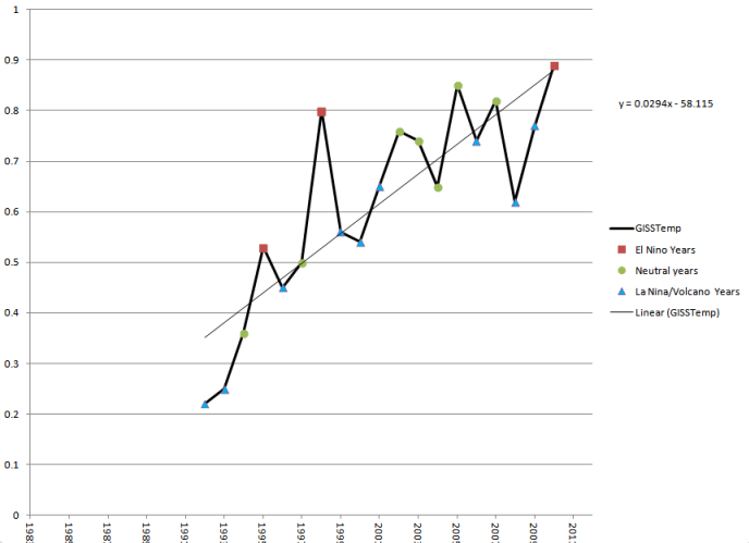

ACC Theory – by and large, I agree with the culmination of scientific evidence that suggests that anthropogenic CO2 emissions, if allowed to continue unabated, will lead to future global temperature rises that will have adverse effects on the ecosystem and, thusly, humans. I take it your issue is with the ECS or TCR value? This is fair. There is still uncertainty in that value. However, as previously stated (hence my confusion on why you’re asking again) I’ve yet to read substantial, credible evidence that suggest that these values should be on the low end. So while maybe you’re not fully in agreement, what is your evidence that it is undoubtedly wrong? Doubting and having credible evidence that something is wrong are two different things. However, “skeptics” appear to blend the two together. And ironically, the only thing that “skeptics” don’t doubt is any and all opinions that attack the ACC theory.
“isn’t the reserve also potentially true” – did you read what my first post? See that big graph that shows a warming trend nearly double that of the long-term average? See the quote from the Rahmstorf et al 2007? But I’ll answer it again…
YES – the reverse is true and ENSO can cause artificially accelerated warming periods. It’s happened. It’s been noted.
BUT –climate scientists who are actually attempting to understand the data honestly, unlike “skeptic” bloggers, understood that it was likely just internal variability, unlike “skeptic” bloggers, and concluded that sensitivity wasn’t actually higher than previously estimated. That’s the difference between honest science and blogger “science”. That’s the difference between skepticism and “skepticism”.
AND – ENSO/PDO, which are purely about the redistribution of heat from oceans to atmosphere, cannot possibly explain long-term warming trends especially warming trends in both temperature and OHC. (and I know pre-2005 OHC data is a dirty word for you but you’ll have to provide evidence that pre-2005 is unusable because nothing in the post-2005 data suggests that the pre-2005 data was off base…and regardless, post-2005 data, DURING THE “PAUSE” shows steady increases)
