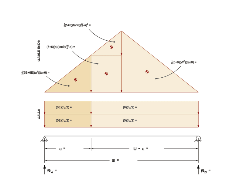

Based on the preceding conversation and considering the following load pattern on a gable roof with wind in the transverse direction as shown below:
I then get the following loads applied to the roof diaphragm (plf):
From this we should be able to calculate the reactions on the diaphragm from the exterior shear walls (no interior shearwalls for this derivation).
We will then check the minimum load case where 8 psf and 16 psf are applied to the roof and walls respectively and also the case where the roof loads are neglected and only the wall loads are considered.
In this particular situation the roof zones 2 and 2E are negative so the load case where the roof loads are neglected will govern.

In summary, the Wind Base Shear @ Load Case A (transverse) would be the summation of all of these distributed loads multiplied by their length of application.

Interesting to note that for a gable roof only the wind forces on the walls contribute any lateral forces to the roof diaphragm and then to the shear walls for the longitudinal direction (wind parallel to ridge).
The breakdown of the forces would then be:
Transverse:
Longitudinal:
One could argue that there is a certain amount of wind force on the edge of overhangs but I'm thinking its insignificant.
