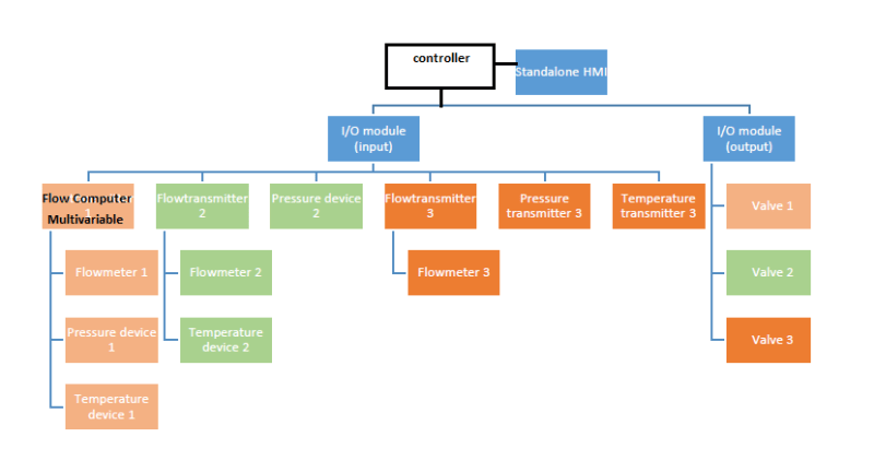

OK i found time.
Link
This sort of thing I was aiming at.
Points of note:
my aim is indeed at continuous flow. Some inputs will be reed switch, but also pulse inputs.
Is a I/O module generally incorporated in a standalone HMI, or is this to be adviseable by it's vendor ( i.e. regarding amount of ports / pulses etc) maybe this is an open door, but I am still learning!
I see that it is not a Single loop, and therefore perhaps a HMI which can handle multiple loops would be handy, or indeed moving up to PLC/PAC. I will check if the first is available widely.

RE: Getting an overview for a HMI based closed process control system
Unless this strictly manual control, you are into the PLC/PAC world because you need a controller to decide how much or whether to open or close the valve.
If the I/O is analog in/digital (like Modbus) out or Modbus to an analog output module, then an HMI could do manual control via input from its screen. But if the flow has to be automatically regulated, then a controller is needed and rack controllers use modular I/O.

Thank you for your reply!
A logic controller should indeed be nessecary in the sample case.
I now am looking for what a company ( duranmatic) offers for combined plc/hmi 's . I see the Horner- APG'scoul dbe an interesting choice, however first I am looking if the programs requeird to configure the logic is easy to use, as programming logic is not my main skill.
