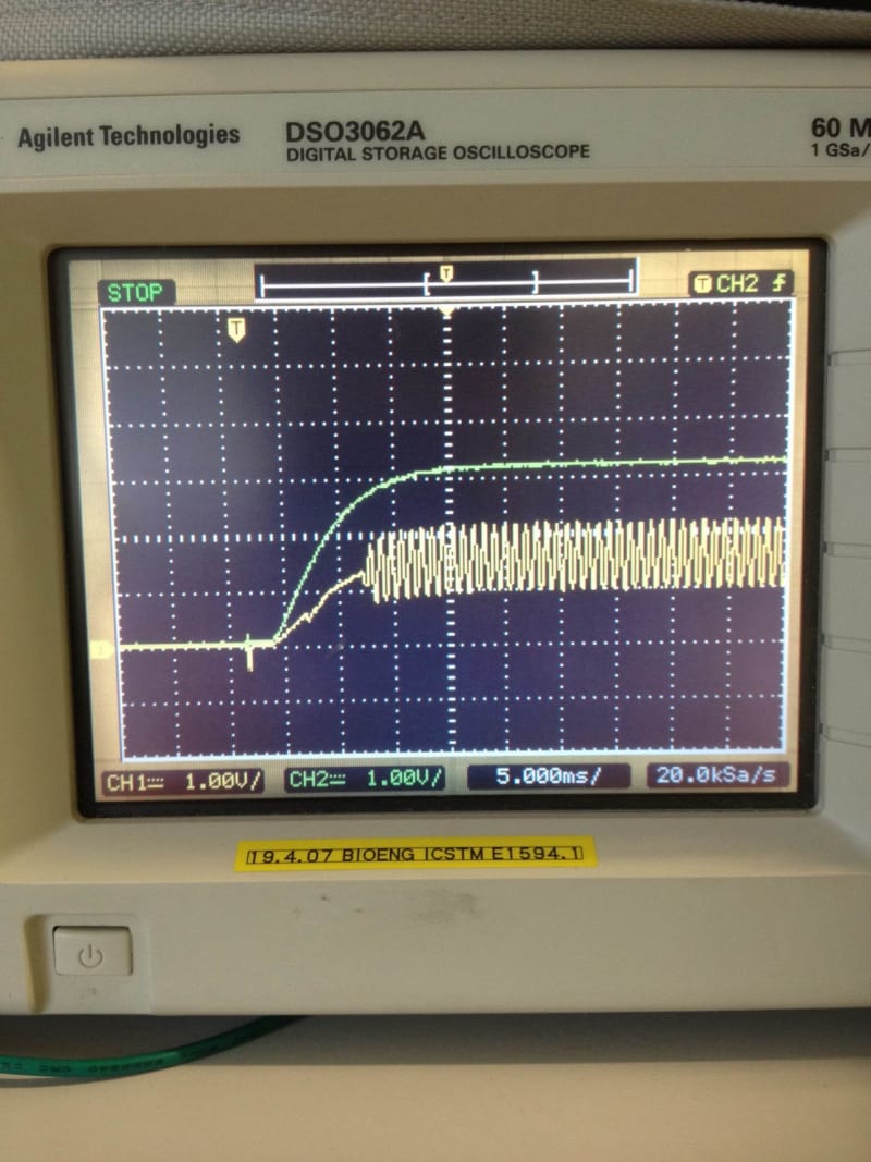

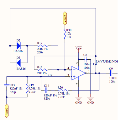

I am building a wien bridge oscillator using an LMV751 opa with an output frequency of 20khz.
The breadboard version of the circuit above works perfectly, the output voltage is around 400mV pp at 20kHz. The breadboard version uses the SMD version of the LMV751 on a breakout board, and 1N4148 diodes.
The SMD version of the circuit is constructed exactly the same, with the only difference that it uses BAS16 diodes. However, a version was tested where 1N4148 diodes were soldered to the board instead.
Both circuits are completely isolated from any other components, and tested using the same power supply, which outputs 3.1V for Vcc, 1.52V Vcc/2.
The issue is that the SMD version has a much higher amplitude of 2Vpp, although it oscillates at extacly 20kHz also. The circuit was tested with two LMV751 chips incase it was a chip defect.
As you can see in the pictures, the breadboard version takes much longer to start oscillating than the SMD version.
Breadboard version at startup
PCB version at startup (NOTE: frequency is the same as the previous image, it appears lower due to aliasing on the scope screen) Also, the circuits were analyzed again using exactly the same input voltage and the results were the same, I just didn't take a picture.
The circuits were build from scratch again and checked over multiple times for any error or difference between them. All passive components (0.1% tolerance ) are confirmed to be exactly the same.
I am completely stumped and have know idea what would be causing such behavior. Any suggestions are greatly appreciated.

One fundamental error in your measurements is that you sample at 100 kSa/s in the breadboard version and 20 kSa/s in the SMD version.
Nyquist wouldn't like the latter at all and I don't like any of them.
For a good optical (scope screen) result, try sampling at at least ten times oscillator frequency or higher. I don't think that the HP scope is limited to 100 kSa/s, so set sampling rate to 1 MHz - that way you will see what is really going on.
Also, check that the diodes are REALLY connected as shown in the diagram. Mounting those little devices with the correct polarity isn't always easy*.

"...20 kSa/s..." Well spotted Gunnar. Need to get a reliable measurement first. There's a small chance that the entire problem is a measurement artifact. Or, more likely, this error may be adding confusion and leading the OP astray. This must be fixed (adjusted) first.
The amplitude will be critically dependent on the characteristics of the diodes. So it might simply be variation in the diodes. Traditionally a small incandescent ("grain of wheat") light bulb was used instead. I'd focus in that area after sorting out the measurements.

You probably don't want to hear this but I spent some time modelling your circuit in Simetrix (a P-Spice program) and although I did not have a model of the LMV751 I used a slightly slower slew rate model of the LMV321. I found that the type of diode made virtually no diference to the amplitude (703mV rms for 1N4148 and 715mV rms for BAS16). I did find that the frequency was 18kHz, not 20kHz with those component values shown in your circuit. I tried several other amplifier models that would work at that low supply voltage and they all came out within a few Hz of 18K. Curious to say the least!
RE: Wien bridge oscillator, diode stabilized, inconsistent amplitude b/w breadboard and PCB
"...the type of diode made virtually no difference to the amplitude..."
I wonder if that might be because the diode models are all very similar?

Thank you everyone for your input. I did some more tests today and below is what I found out. Basically, the punch line is that Wien bridge oscillators are apparently horribly unstable in terms of voltage, that or my breadboards are haunted...
Firstly, let me be clear that C9 was never included in any of these measurements/circuits, I soldered it off my PCB to test this circuit ..
Secondly, Brian, the frequency is just a simple RC time constant: 1/(2*pi*820e-12*9.76e3) = 19.886 kHz.
Thirdly, sorry for the sampling/data I showed, those were just quick and dirty pics for me. I can assure you the frequency is correct for all the circuit versions I tested so far. Also the rest of the pics are taken with the same parameters
Although my original question was regarding my breadboard (BB) vs PCB I decided to eliminate all the variables and breadboard a whole new oscillator from scratch. I even took the BAS16 SMD diodes and mounted them on break outboards.
As you can see from the next two pictures, the same circuit, made with exactly the same through hole components (and the LMV751 on a breakout board), acts relatively the same using BAS16 or 1N4148 diodes. This is surprising, since they are what I thought would have the largest impact on the amplitude, since they are what cut it off technically. The only observable difference is that the BAS16 are quicker to ramp up.
New breadboard with BAS16
New BB with 1N4148
As you can see, both these breadboards give me much higher Vpp (1.2V) than my original BB but not as high as the PCB (1.8V)
The next picture is old BB that was giving issues (posted again to appease Nyquist and the rest of you ;)
Old BB with 1N4148
The old BB was measured again with another LMV751 chip and it acted the same as before (Vpp=680), furthermore, the LMV751 chip from the old BB was put on the new BB and the new BB acted the same (Vpp=1.2).
At this point I had two IDENTICAL BB, checked over 3 times by myself, as well as a lab tech with 30+ years of experience at Phillips and neither of us could explain the readings we observed..the only physical difference was that one BB was slightly smaller than the other, and a slightly different shade of white !!
However, touching the components here and there, I noticed that if I touch either side of the 200k resistor, the amplitude of the osculations increased dramatically (~2Vpp). This was replicated on both the old and new BBs. Assuming this was my stray capacitance, I added a 3nF capacitor from the node between D2 and R17 to ground and this confirmed my belief. The cap increased the amplitude of the oscillations.
To see if this was the cause of the increase on my PCB (since I have a large ground plane under my oscillator circuit) I measured the capacitance from that node to ground and got a reading of 3pF... no dice!
I gave up at this point, and while touching the circuit some more, I realized that touching the ceramic part of C14 slowly (~10mV per sec) kills the signal while touching the ceramic part of C13 increases the signal. This turned out to be due not to my capacitance but due to temperature.. Apparently the 1% through hole capacitors I bought are garbage at Temp sensitivity and change their capacitance even from the heat of ones finger..
Long story short, unless any of you have something to add that I missed (I really really hope you do!!) let this be word of caution for those trying to get a predictable amplitudes from a diode controlled wien bridge..
1. You are still sampling at a rate that is equal to the expected frequency. You cannot get any valid measurements from that. Increase the sampling frequency to at least 200 kSa/s I would use more. Didn't you read my and other guy's posts?
2. Don't be ridiculous. "Brian, the frequency is just a simple RC time constant: 1/(2*pi*820e-12*9.76e3) = 19.886 kHz" is being ridiculous.
Skogsgurra, my oscilloscope chooses the sampling rate based on the time interval I as it to sample (at least as far as I figured out how to use it).. In this case, sine I am sampling 5ms it samples at 20k.. I dont care about the fact that it cant accurate measure frequency at this point since all i want to see are the start up characteristics.
The frequency measurements are made at 5MEGA samples per second, and thats how i know everything runs at 20k.. i just decided not to show boring pictures of sine waves to everyone...

"Another (idea) was to use thermistors, however I doubt the tiny amount of current this thing drives will heat it up significantly."
As mentioned previously, the traditional amplitude regulating element is a small incandescent ("grain of wheat") light bulb. Many designers spend a great deal of time and effort eliminating the bulb, perhaps not realizing that the bulb operating point isn't normally set to glow, and thus their lifespan might be essentially indefinite.
