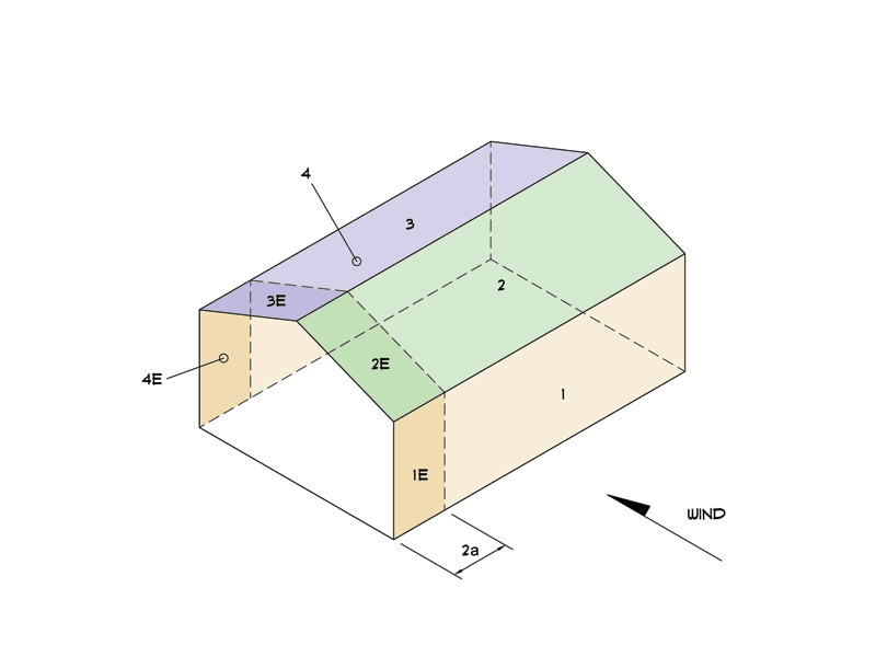

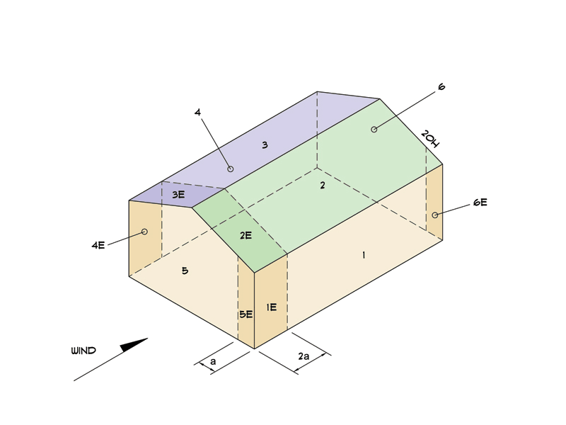

As I started plowing into the programming of my new web based MFWRS wind load calculator I decided to try and pick up as many roof types as possible. I'm intending to use the Envelope Procedure from Part 1 of Ch. 28 of the ASCE 7-10 so things are a bit limited with respect to building aspect ratio, height etc... Section 28.2 specifically states that one can use this method to analyze buildings that have gable, hip and flat roofs.
My question is can this method also be used to analyze Half Hip and Dutch Gable roofs which are essentially somewhere in between a Gable and Hip type roofs? Rationally it makes sense to me but just thought I might throw it out to the crowd for any comments or corrections.
The five possible roof types would then be:

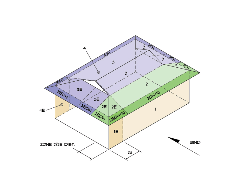

Another related question, and one that I can't seem to find answer for anywhere online, is what happened to the pressure zones 5, 6, 5E, and 6E in Load Case A of the envelope procedure. Yet if you turn to the commentary for chapter 28 the diagram showing the envelope procedure applied to a hip roof clearly shows zones 5 and 6 in load case A.
Notice also in the notes that one should use the coefficients from Table A for both Load Case A and B for a hip roof. Unfortunately, Table A is missing zones 5, 6, 5E and 6E.
I'm confused.

No disrespect but I think you have a point Archie264, these questions are beyond the pay grade of most practicing engineers. I do like to ask the hard questions once in a while though. I still can't reconcile Figure C28.4-2 with the Load Case A table of Figure 28.4-1. I'm missing values for surfaces 5 and 6. Comparing tables across multiple version of ASCE 7 I've determined that the TABLE for Load Case A should include two additional columns for surfaces 5 and 6 with values of -.45 for both. These values are constant for all values of roof pitch. This then fixes the problem for hip roofs.

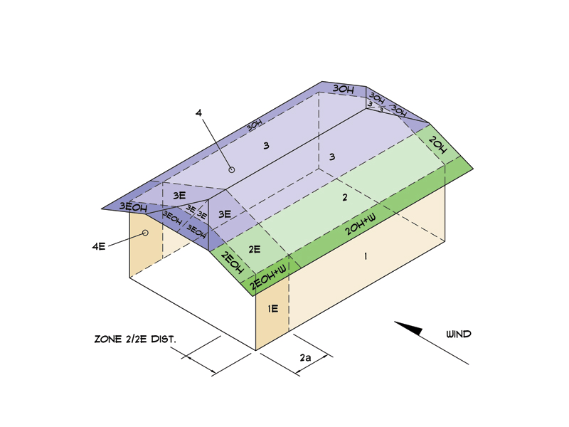

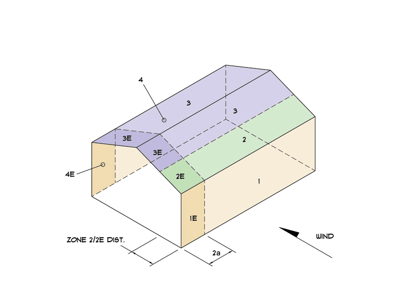

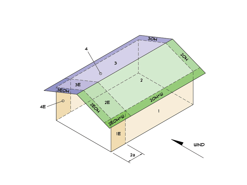

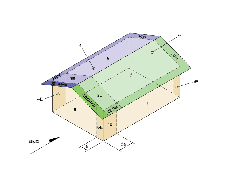

Notice the complexity when overhangs are added to the roof. These load diagrams show the Envelope Procedure for a Gable Roof:
Load Case A:
Load Case B:
If torsional load cases are required then another Load Case A and B are required for the torsional load case.

I'm not sure I'm applying the positive external pressure on the bottom surface of the windward roof overhangs properly but I'm trying my best to interpret Ch. 28 as accurately as possible.
So racookpe1978 what are you suggesting with the way I'm analyzing the standard gable roof? I can understand your observations but what is the conclusion to draw from all of this?

RE: Wind Envelope Procedure with a Half Hip Roof and Dutch Gable
According to Sec. 28.4.3 of the Standard windward overhangs experience a positive pressure on bottom surface of the overhang (uplift) with GCp = .7
The Design pressure for this uplift would be calculated as P= qe * GCp at Load Case A since the overhangs are at the height of the eave height. For the gable overhangs I am calculating the Design Pressue using qh since the overhangs vary from eave height to ridge height.
Note that this is different from the Directional Procedure which as suggested above equates the windward overhang pressure to the wall pressure below (Sec. 27.4.4).
With the envelope procedure the max. windward wall pressure coeff. is GCpf = .56 in the interior regions (transverse case), which is different than GCp = .7.
For windward overhangs the total pressure becomes:
2EOH+W = (qh * CGpf2E) + (qe * GCp)
2OH+W = (qh * CGpf2) + (qe * GCp)
All other overhangs along the sides and leeward sides are simply the velocity pressure (qh) multiplied by the appropriate external zone coeff. GCpf, so for example 2OH denotes:
2OH = qh * GCpf2
Which is the same as zone 2 except there is no internal pressure coeff. applied.

Compare the pressure profiles for a hip with the gable roof(Load Case A):

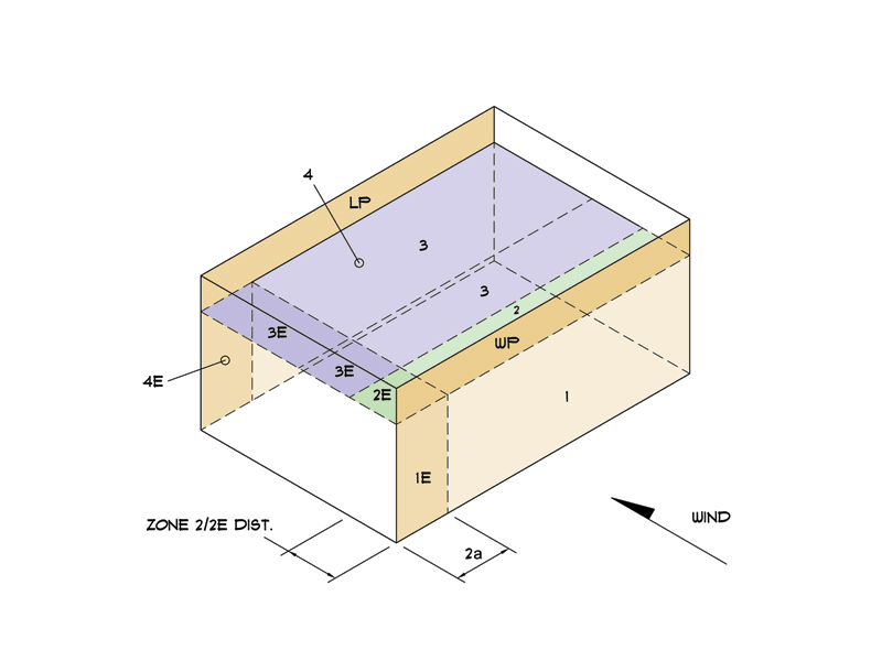

This is my best guess at the pressure distributions for Dutch Gable, Half Hip and Flat Roof types using the Envelope Procedure:
