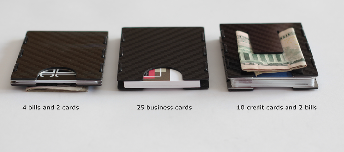

Realized I never uploaded a photo. Here is a similar concept to what I'm trying to design around; an integral cantilever spring in a flat plate.
RE: Cantilever Spring Clamp
Any thoughts ? Can a plastic provide this type of cantilever spring force effectively and reliably ?
Until you stuff a Gypsy Bankroll in it, yes.
