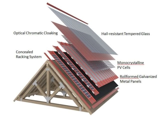

Given those complexities of backfeeding through a "step-down" power transformer, how are the telephone-pole household power transformers handling today's new requirements from the governments to allow backfeeding the household transformer from a house's solar cells? Are those transformers at risk of early failure because of this unexpected backfeeding (step-up) of voltage and power back to the power lines?

THAT is 'nother whole story. Not applicable here. The boost transformers don't see any voltage on their secondaries unless there is a solar, wind, hydro, fuel cell car or other power source connected locally. And then, you will not have any voltage induced unless there is a reverse power flow in the secondaries of the transformers.

Since the inverter has to have a hot line to start production, inrush from the low side doesn't happen.
In the past, the amount residential solar was very small compared to the capacity of the distribution circuit, so the simple solution was to just have the inverter trip and stay offline during any power system disturbance, thus avoiding the issue of providing a ground path for the high side of the service transformer. As the amount of solar on a feeder increases above 15%, everything gets more complicated.
Voltage regulation at the customer's premises can be an issue. If the utility feeder is at 105% voltage on the medium voltage side and an inverter is backfeeding through the service wire and service transformer, the customer's equipment could be damaged by voltage well above 105% on the 120/240V side.
