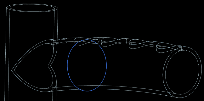

Hi all,
In NX, how do we extract centerline from this kind of feature below? I have been trying to use PMI centerline, but PMI centerline seems cannot be re-use for other application.

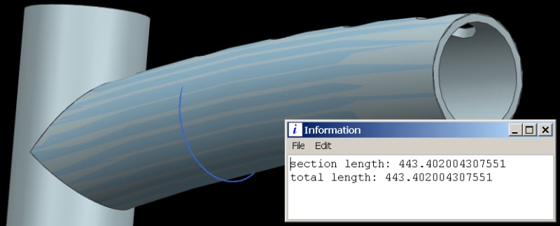

Hi SvenBom,
Thanks for the introduction to a vast knowledge of NXOpen behind it. I am fascinated. I have also glimpse through the code at nxjournaling.com by Cowski, tried his centerline simple demonstration. But I will just update my progress result with that code as below.
It seems the result is unexpected probably due to my tubes are hollow and there is an intersection which is not tangential.
The GTAC method works fine, but requires manual effort.
Anyway, thanks for giving my a direction.
