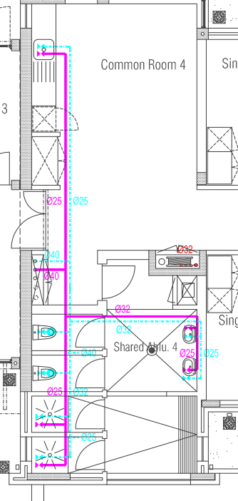

I went to site today and managed some more information.
First, PEDARRIN2:
The showers are controlled by 2 taps - not a mixing valve. The water in the tank was about 58 °C, but it never drops below 55°C, and rises to 60°C - so the hot water is fairly constant temperature and is controlled by the heat pump.
At the bottom is a basic detail of how the showers are piped.
I witnessed the problem first hand. When the hot water is running alone, there is virtually no temperature fluctuation, and I estimate the temperature to have been about 40-42°C (I could hold my hand there, but it would probably have been too hot for my body). The water pressure feels fairly constant. Once I open the cold water tap to try and control the water temperature a bit lower the problem starts to come up.
Firstly - the cold water tap is only required to be slightly open (don't think it's 10%) to achieve the desired temperature, then when there is additional cold water draw-off (opened the basin), the temperature rises quickly and then suddenly falls down all the way to probably 20°C. This all happens in less than 30 seconds. The temperature keeps oscillating without any change in the valves - I can imagine that if you are showering, you will try to compensate to the cold temperature by closing the cold tap.
Now, moving up to the plant room - I did nothing to control the draw-off, it was just the regular draw-off from the students using the showers etc.
The pressure at the pressure gauge after the pump oscillates like crazy - the pressure would be about 410 kPa and gradually drop to about 390, then quite a sudden drop to about 325 kPa (assuming draw-off), the pump starts to compensate and within seconds it jumps to about 450 kPa.
The pump makes a terrible rattling noise at low speed. The plumber said that the bearing vibrates at low frequencies.

Ok, after the weekend, the pumps were off, and the system is no better. I think the pipe sizes to the basins and the WC's are too large and aids the problem. Also the basins and the WC's are upstream from the showers.
Another theory that kind of ties in with the tanks acting like bladders, is all the pipes are monolayered plastic, and the hot water pipes act more like bladders than what the cold water pipes do. I've theorized that in my head, but I just can't get myself to believe it.
The table below gives the corresponding copper diameter:
Copper Plastic
15 mm 20 mm
22 mm 25 mm
28 mm 32 mm
35 mm 40 mm
42 mm 50 mm
54 mm 63 mm

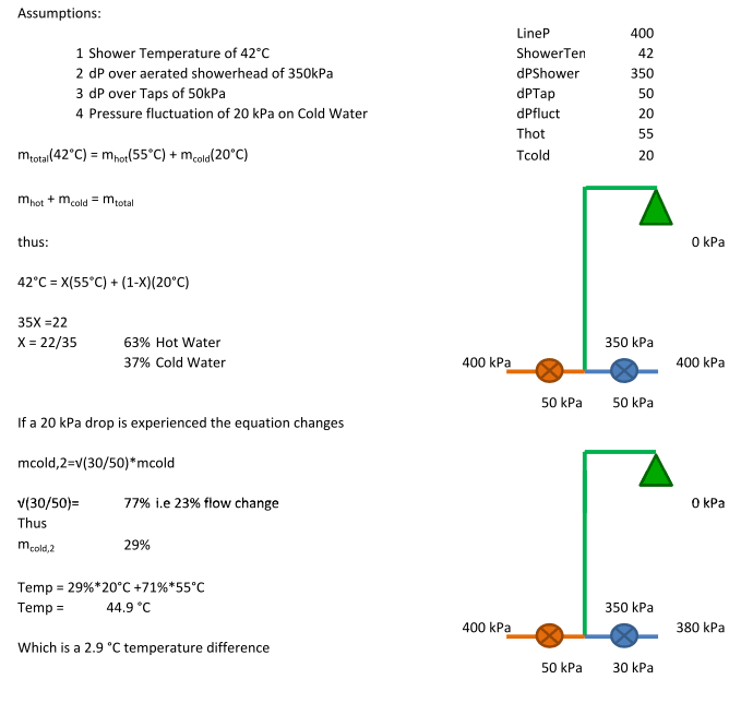

I have spent the last couple of weeks on this problem and it seems that the effect is the classical draw-off effect.
Where a shower is running and a WC/basin on the same line draws off water, the shower gets less water and the balance goes off.
What confused me at first was that the pipes seem to be sized sufficiently to handle the flow.
The problem is that the water saving showerhead made the fluctuation worse.
The calculations below are only of an illustrative nature, but it shows that when your showerhead has a big dP, a pressure fluctuation on your supply line causes a much greater fluctuation than when it has a lower dP.
We adjusted the angle valves at the WC's and basins and that greatly reduced the problems, and the 25/27 votes on a facebook poll agreed that the problem is solved.
