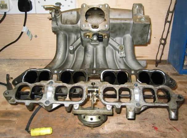

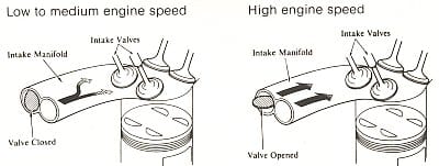

lastly, everybody likes pictures!
traditional toyota tvis
M3 ITB
Dual port interal wastegate actuator

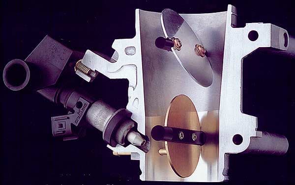

Take a look at any 2004-ish through 2010-ish Suzuki or Kawasaki sportbike throttle body. They have two throttles for each cylinder ... one operated by the rider, the second operated by the computer, and at lower revs, the second one is only partially opened if the rider asks for full throttle.
The newer ones have gone full drive by wire with only one set of throttles, but same idea, at certain engine speeds when the rider asks for 100% throttle the computer doesn't open them all the way.
So, not only has it been "experimented with" but it has been in production for years. I suspect that you didn't look outside the automotive world and consider the motorcycle world.

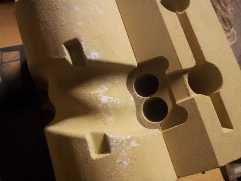

I did however make a cast split runner intake manifold system to bring some life back into a 16v vw engine - If i could only find the time to travel 500miles to my nearest RR Ill let you know results. Its similar in principal to the TVIS image above.

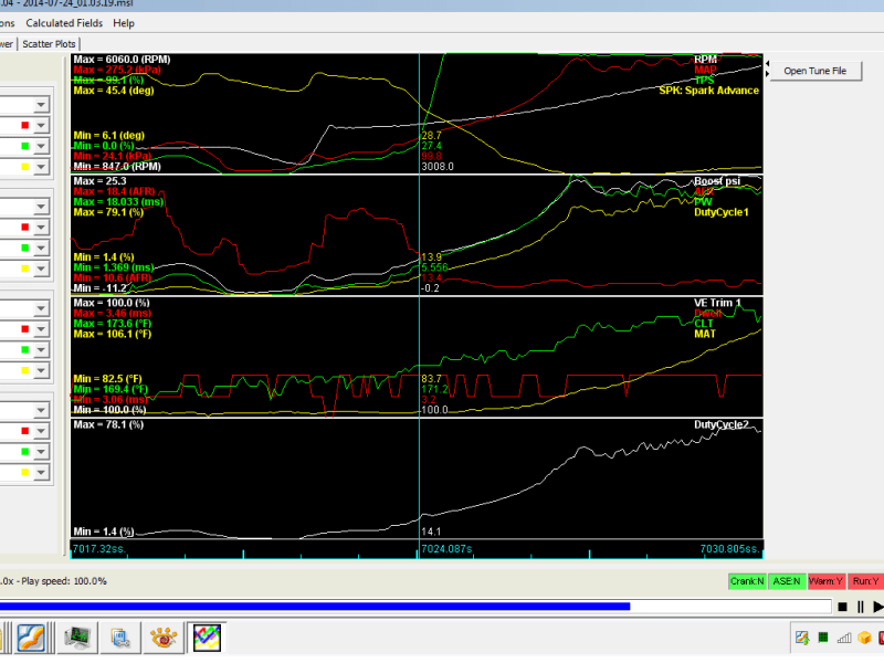

Well if your map sensor is pegged at atmospheric at 30% throttle at lower rpm there is no extra charge density to be gained from the other 70% throttle opening. There is a drastic reduction in velocity though for the same non - gain in density. Higher velocity of equal density equals better cylinder filling and a denser charge where it needs to be when the intake valve closes.
Say for example you are accelerating at low rpm and high load, high gear. Is it possible that holding a smaller throttle opening (still at full atmospheric pressure on the vacuum gauge) could yield more torque and better acceleration than WOT because of a higher intake velocity in the port around the throttle there? Has anyone ever done back to back dyno or accelerometer logs through different throttle openings on an itb setup? I am willing to bet WOT does not result in maximum torque at all rpms.
The variable geometry tvis design I used as an example closes half the effective port area off at lower rpm. This is irrespective of manifold pressure or restriction as I am proposing to account for. It is based on rpm alone, and yet it makes MORE torque where that runner geometry is favorable to wave tuning.
I am proposing that at least for cross sectional area, not length, you could tune an itb system as a fully variable version of this principle. The tvis system unlike say a cyclone from mitsubishi, does not even have different length runners it is deactivating at lower rpm, they are the same length, all they are doing is closing down half the flow area. Why is an itb held at half throttle in a single runner much different?
THIS ^, is exactly what I was looking for and suspected. Thank you. I was aware of sport bikes using dual throttles but did not understand if that was their function. I did try and research it but couldn't find a whole lot of technical information about it's function. Most people seem to just discuss them as chokes and operating at warm up. I think that is maybe a misunderstanding carried over from carby times. Which I understand was not that long ago in the sport bike world.
Well it certainly gives lots of credence to my understanding. Do the factory service manuals detail the function of these secondary throttles? Why have no aftermarket itb manufacturers caught on to this? I don't think the mechanical system i proposed would be that difficult to build and implement for generic applications.
That is pretty crazy. It's not exactly what I was talking about but still very impressive. Have you got picture or details of your system anywhere online already? I take it RR is rolling road? You could still get very useful information from an acceleromter setup like a gtech, it sounds like the costand time to travel to the dyno alone would offset the cost of a gtech for you.

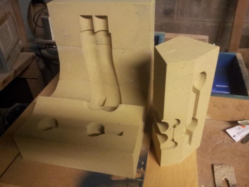

I dont have a picture of it fully complete on this harddrive but here are three ''along the way'' shots that may give you an idea on what the finished 'thing' looked like. It consists of a cast port splitter section with deactivation butterflies - attached to head, and 4 sets of twin runners off that upto a common plenum - the sand mould below is from one of the 4 twin runner sections(minus the cores). Its not what Id call crazy, just some weekend tinkering...
As for travel costs to the RR, Im hoping someone will want me near it someday at their expense and the intake will happen to walk into my suitcase the night before...
Theres another bike intake too where a set of longer trumpets hinge onto short ones at lower rpm to catch a different wave pulse - the name or model wont come to me at the minute.
The long and the short of it in terms of intake manifolds is that 'It all Depends' and 'Everything will be a compromise' 'Excels at a particular rpm over another' and so on....

The current Yamaha R1 uses the motorized velocity stack arrangement.
Regarding the dual butterfly arrangement, it's true that the RPM range affected by not fully opening the throttles is below the meaty part of the engine's torque curve, but it does affect starting off from a stop (e.g. starting a race - whether roadrace or drag), and for a street ridden bike, that rev range will make it feel more punchy during normal riding at lower revs.
It can be said that the constant-velocity carburetor that was traditionally used (in a one-carb-per-cylinder arrangement) is another form of variable intake runner. In fact, the first generation of fuel-injection on the Yamaha R1 (2002 - 2003) used vacuum-operated slides just like those of CV carbs, they just weren't involved with fuel metering the way a CV carb slide is.
The major redesign in 2004 eliminated the vacuum-operated slides and replaced it with a servo-operated secondary throttle, same as Suzuki and Kawasaki had already been doing.

Here is a picture of a datalog from an engine I tuned. Granted it has a big turbo and that confuses the issue here but it's a 2.3L engine with a 90mm throttle.
Look where I have the marker set, 27% throttle is already almost full atmospheric pressure. 99.8 kpa, 100 is atmo. So what is all the rest of that throttle opening really doing until the turbo spools and fills in the gap there? At that particular rpm without any boost a throttle 70% smaller would make the same torque. It's even worse with big itbs on sport bikes. Those engines really can't justify those throttles until 10k rpm +. At lower rpm it's just killing port velocity and in turn charge inertia which greatly hinders cylinder filling with those big cams. The idea is a variable restriction yes, but not in the sense that it's choking the engine or limiting anything, it's just covering for gross excess.
