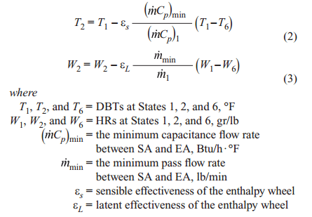

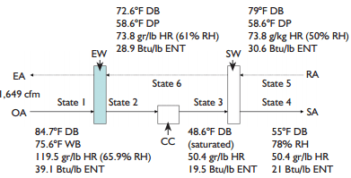

for the following doas :
In the process of design I need to substitute in the following equation linking enthalpy wheel sensible and latent effectiveness with t and w as follows :
The question is : what is meant by capacitance flow rate and minimum pass flow rate ?

Capacitance flowrate is mass flowrate times heat capacity... which probably was explained in class.
this looks like a Semco Pinnacle system.

Quote (this looks like a Semco Pinnacle system.)
yup
its an ASHRAE paper talking about the design steps of DOAS system coupled with a CRCP .
Quote (Capacitance flowrate is mass flowrate times heat capacity... which probably was explained in class. )
So what does it physically resemble ?
And what do you suggest I shall substitute for Cp with ?
If putting Cp = 1.02 KJ/Kg then whats the point of Cp in the equation if its going to be cancelled in num and den . Cps(Cp and Cp_min) should have different values.But how to find each ?

Specific capacity of OA and EA could be different. Imagine -15°F OA with almost no moisture, and 70°F EA with a lot of moisture.
What are you trying to do? In most cases the manufacturer would have a software for their equipment that you can use for sizing. You wouldn't know the specific wheel effectivenesses at a specific flowarate anyway.
for example a 3000 cfm ERV has different effectiveness at 2000 cfm than at 3000 cfm.
If you really want to get into detail, I suggest reading up on the Thermodynamics book and use EES
