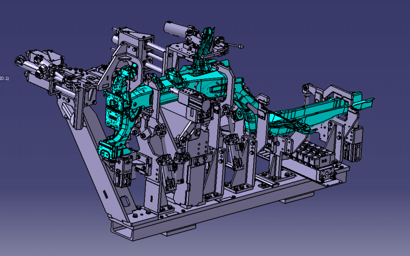

I have just started to use the Catia V5 R21. I have an assembly consising of „two parts” (drum.png). I would like to make a draft from this assembly. I would like to set default colors for each parts in drafting (capture.png)

If I understand what you want, you can go to the properties of the view(s) and under the dress-up section select the option '3D colors'. That will make the parts in the view match the color that they are in the model.
