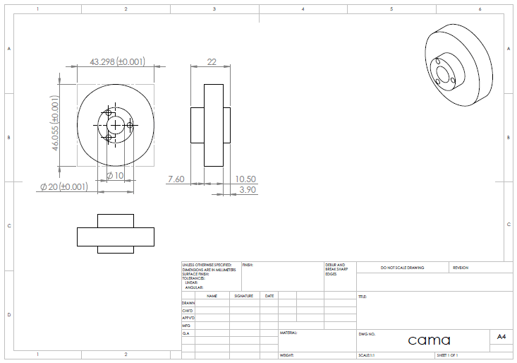

Hi, guys,
I have a cam with an irregular shape, about 10mm thick and about 46mm in the longer diameter. I need this to be cut and precisely ground to micron tolerances, if possible. There are three CNC ways of achieving this, in my book: wire-cutting (really not preferred because of the surface decarburization occurring, reducing the sliding properties), milling (but I can't find any CNC mill able to work with sub 0.01mm tolerances) and irregular shape grinding (which should really do the trick).
However, I do live in Romania, and apparently we're a technologically stuck behind country. I scoured far and wide but couldn't find a single CNC grinder able of more than just flat/round grinding. So, I'm coming to you guys with my questions:
1. Is there any other way of achieving this kind of surface, other than the ones I enumerated? Should I look for any different method?
2. Can you recommend anybody able to help me with my project?
Thank you so much,
Eros

RE: Irregular shape cam grinding
@MikeHalloran The shape is something like the marriage between an oval and a hexagon, or an oval with 6 slightly protruding diameters. Not on oval, not a circle, you know.
About the technical drawing: of course I included it in the quote requests, and it DOES show the required tolerance (even if I explained to the locals that I would be willing to lower the standards and to accept a +0.01mm tolerance instead of the +/-0.0001mm). And of course I also sent out any file format they requested (dwg, dxf, step, stl etc.) And of course I mentioned it's about a unique part, for now. Your advice comes to confirm that I've been doing the right thing with my research so far. I even went ahead and started asking the local CNC distributors for references about any of their clients who might be able to help. Still no news so far.
Did you search for "camshaft grinding"? Even with your reduced tolerance of .01 mm (.0004") the part would still be risky. I'd plan on making several blanks in the hope that one piece would be within specifications after grinding.
I also think you probably need centers on the part (if done by turning) and some sort of call out on the profile tolerance and the concentricity requirements between the outer profile and the inner hub. You probably also should specify the temperature at which the measurements are made.
Your drawing does not specify anything about the shape of the cam between the four tangent points, and it doesn't really locate them relative to any useful datum.
A cam grinder would expect to see an equation, like
R = f(theta),
or a table of R,theta
where R is the radius relative to a specified datum
and theta is an angle, measured from an index datum like a notch or hole.
Or, if it's supposed to be four orthogonal flats with radiused fillets between, you need to specify the radius of each fillet.
The actual cam profile is also affected by the nature of the follower. I.e., if you are using a flat tappet sort of follower, the shape will be different than that of a roller cam for the same motion. Cam drawings often include a view of the cam and follower assembly, with an equation or table defining the follower motion, not the cam profile per se.
Hi again, guys,
@BrianE22: yep, the parts have concentric surfaces - including an inner surface - that of the 10mm hole - fit for grinding. Also, when I sent the parts for grinding (everything but the external shape) I specified the tightest concentricity tolerance possible along with the press-fit tolerance for the 2 side bushings. About the temperatures - read on, below ;)
@MikeHalloran: I only call this part a "cam" because of its general shape. However, it's not an actual cam (it doesn't lead a follower in the classic sense), as it is rather a "symmetric variable radius pusher" - nothing to do with the classic geometry of a cam. A normal cam shape is easily defined with mathematics similar to what you described. However, my "cam" shape is defined by some pretty complex trigonometry, so complex in fact that I let SolidWorks do all the math here. Impossible to be translated to anything closer to what a regular cam grinder would be able to use.
What I took from this thread so far was the idea of using grinding (thanks, @ornerynorsk) to shape this complex part's outer shape. However, the cheapest jig grinding service I could find was a German company which asked 180EUR(225USD)/part to grind.
So we've come up with another crazy idea: to build our own lever-type 1:10x pantograph, and to grind the cam's outer surface on a regular flat grinding machine, by reducing 10x a 10x bigger template cam. This way, any machining error on the big/model cam's shape would be reduced 10x on the small, actual cam. The mathematical model was verified in SolidWorks and proved viable. In order to eliminate the temperature-to-size variance dependence, we round-ground the cam parts' outer surface to an outer diameter equal to the max. diameter of the actual theoretical shape, to micron tolerance, in a controlled environment, in another dedicated shop (a very common and thus affordable operation). We then used a permanent marker to paint the cam's outer shape, and mounted the cam on the pantograph we built. By keeping the two cams (the regular one and the 10x bigger one) in perfect sync via a timing belt and pulleys, and by rotating them while gradually and precisely bringing the grinding wheel down against the cam, we can grind away the required shape, until we're left with only a thin line of paint on the cam. The beauty of the principle is that this way we're not depending on the room temperature anymore - you can see why.
