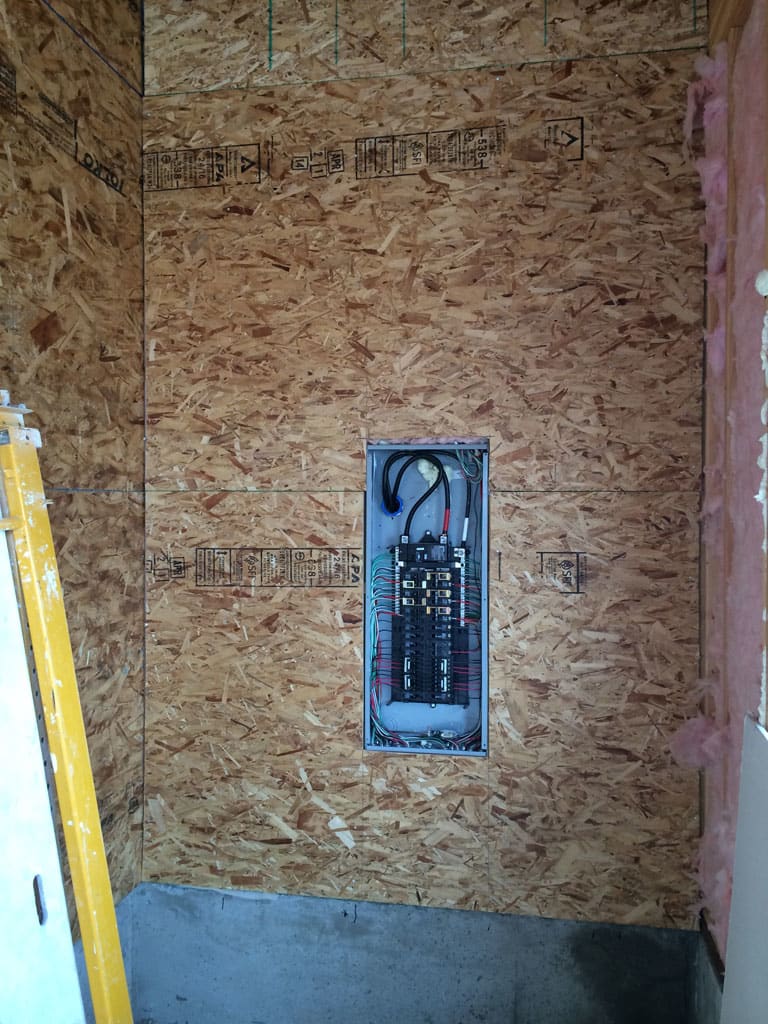

The picture below is a recent repair job that I worked on. Single story commercial building in a 155 mph (ult) wind zone. Over 60% of the gable end wall was compromised. The fix was both presciptive and engineered. Any thoughts on what you might do?
I guess this is a good example of "What not to do as an electrician" or any other trades person for that matter.

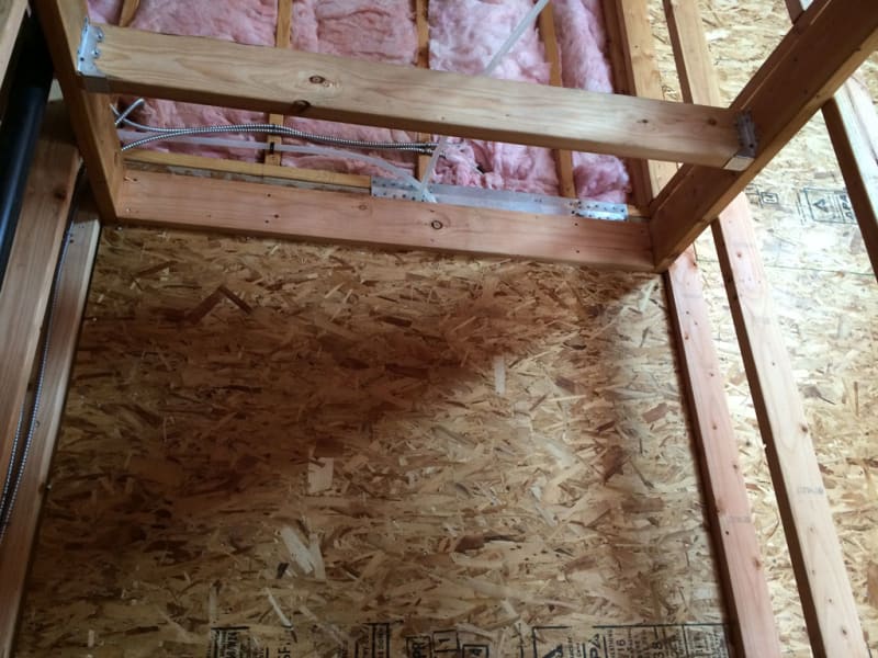

Notice how close the slot is to the sill plate in a couple of studs. A strap fix in my opinion could not develop enough strength below the slot. Also the amount of wood left towards the exterior side on a couple of the studs (not visible) was less than 1". My worry there was that the bending forces on the studs from the wind would put these specific areas in considerable compression. A strap on the outside would be great for nail protection for the wires and tension but do nothing for compression due to bending. Part of the fix was to sister 2x4s (flatwise) onto the 2x6 studs against the ext. walls in these areas.

Nail a full height 2X6 to the inside edge of the wall, transverse to each of the studs. Nail off top and bottom with framing clips and 12d @ 6" staggered at the "L" intersection of the studs. Also glue the stud edges together. Should be better than the original.

Basically that is what we did but with 2x4s, and then as an added measure we had them sheet the interior wall with OSB. The wall is now stronger than the original.

How long is the wall? (How much further (to the left) does the damage run?)
RE: Damage by Electrical Contractors
One more stud bay to the left and two more stud bays to the right.

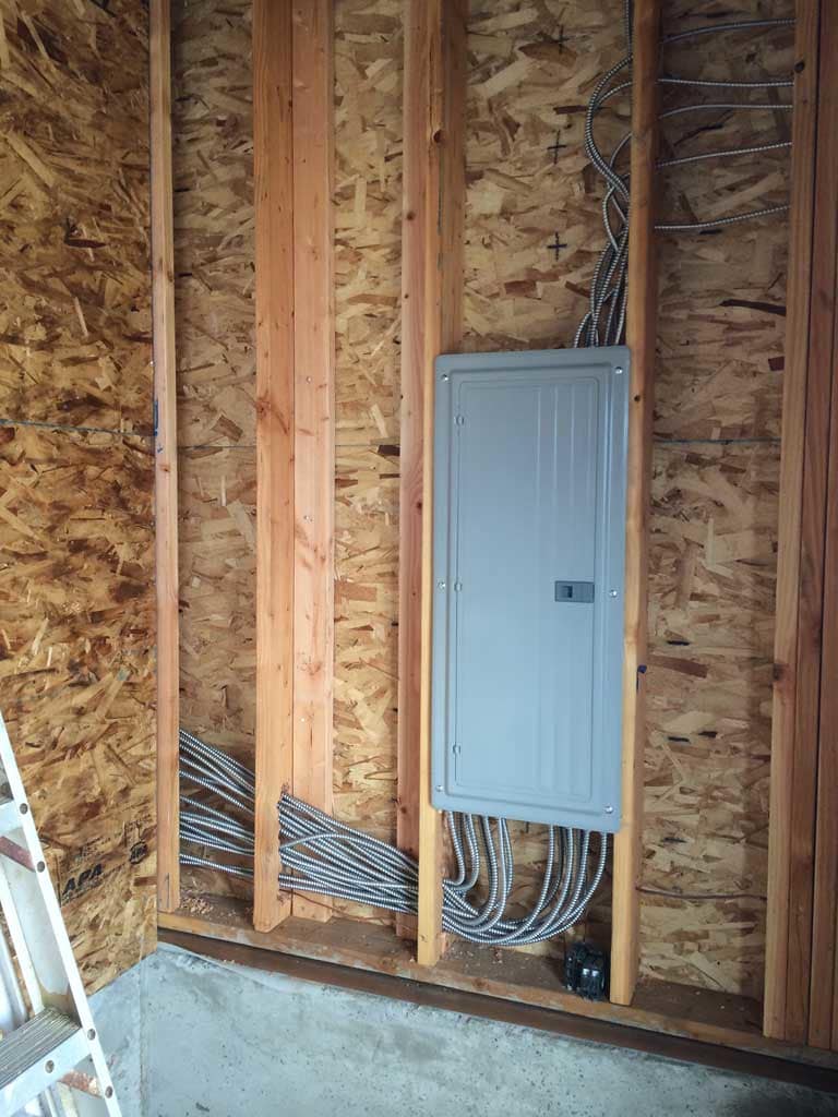

have the electrician reroute conduits to attic or lower level and feed into wall at DCO and switch locations. Then replace or add on studs.

Run a vertical 2x4 between the holes (slots) and the face of the existing 2x4, the second 2x4 in each 16 inch interval to be at right angles to the first 9original) 2x4; and the second 2x4 to be nailed to the first so they make an "L" that fits between the floor baseboard and the upper (usually 8 ft) 2x4 header.
That will resist the vertical loads, and the twisting loads as well.

The newest pictures seem to reinforce that the problem didn't lie with the contractor, but with the MEP engineer, and his lack of communication with the architect.
It's poor engineering, to stick your head in the sand and issue out drawings you know cannot be built,or maybe it's worse, when you really have no idea if it can be built.
This is a fairly small project, but these problems tend to scale up with the size of a building ,at which point ,it's next to impossible to get direction on how to proceed with a fix ,to such a poor design. The endless stream of RFIs that get shuffled from one office to another, with no one willing to admit culpability. " Have the electrical contractor stand there and hold up the wall for the life of the building." Typical... "have the contractor pay for my piss-poor design...he should've seen this at bid. I spent 6 months designing the thing, hell, he's got two weeks to put a price together, and find all my mistakes".
