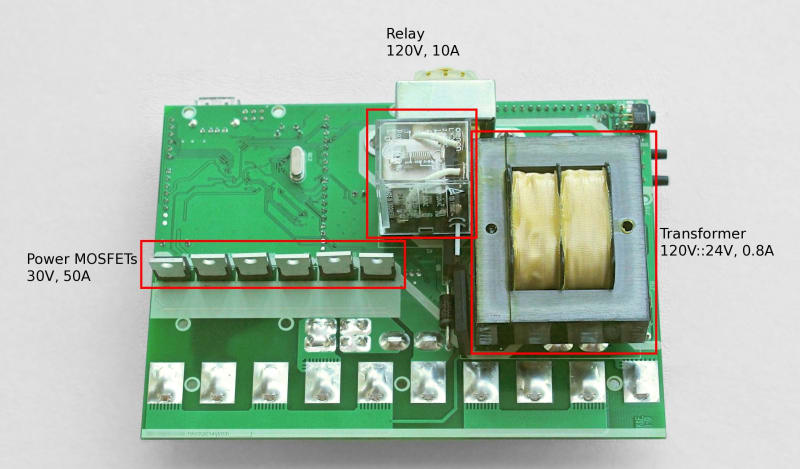

Hi All,
I have a problem with the relay on a custom PCB I designed. On my breadboard prototype the parts where somehow spaced out enough to not show the problem.
The relay I am using is a DPDT 120VAC (Mouser: 653-LY2-DC24). In 50% of the switching operation, a button is triggered as a side-affect. It is 'Push_button1' or 'Push_button2' that get triggered - luckily it does not also trigger the reset-button. I found some resources talking about arc suppression at relays that are RC elements. But I dont know how to use that with a DPDT relay. I use the relay to switch a load between 2 power sources.
Any suggestions?

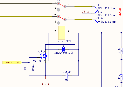

Keith, I have a flyback diode, see below circuit.
>Does your phantom switching occur only when switching a load or has it ever occurred with no load involved.
That is not 100% clear at the moment, I would have to construct an test program to do lots of switching and measure.
So in case its the arc, between which pins 1-6 do the RC elements go?
(5+6 are load and 1/3 and 2/4 are the 120VAC source)
RE: Relay EMI is triggering sensors on custom Arduino PCB
Across the load. That would be between JT1 and JT3 for one load and between JT6 and JT3 for the other load.
The R in the RC combination can be reduced down to around 10 ohms, if necessary. A 10 A Contact can easily handle that.

Gunnar, the relay is switching both poles of the same load, so JT1 and JT3 belong to the same single phase AC plug. Also what I need to add is that this is basically the core of a UPS. That means one source (pins 1/3) are coming from an DC-to-AC inverter where the load is not against neutral. The other pair (2/4) is from mains power.
OK, then connect between JT1 and JT6 - i.e. across the load.
I think problem come from initial high di/dt, not from contact arcing. From photo, PB1 and PB2 are far away form Arduino connector with very long traces that go too close to relay. For PB3 (reset) it's not same situation - it's close to Arduino connector - and don't "see" same EMI in traces. I think you need to redesign PB1 and PB2 position to eliminate such problems. May try to reduce resistors of these Arduino lines to minim (maxim allowed current) to increase noise immunity. For this card, may cut traces from PB1 and PB2 and replace them by wires (twisted or better shielded).
Designing a low voltage digital system on the same board as high current, high speed is certainly doable, but it requires extremely careful planning, and generally, more than a 2-layer board, particularly if signal lines are running through the high current sections. I've worked with boards that dump 120A in 60 ns that didn't have any problems, but the signal interfaces were all differential AND isolated through pulse transformers or opto isolators to prevent interference.
TTFN
I want to stick with 2 layers so I might re-consider the location of the buttons. I just bought the right Resistor+Cap and will install it at the weekend. Additionally I will create data logging around the push button events to dump out all sensor data, especially from the hall sensors and relay state. This might bring more clarification.

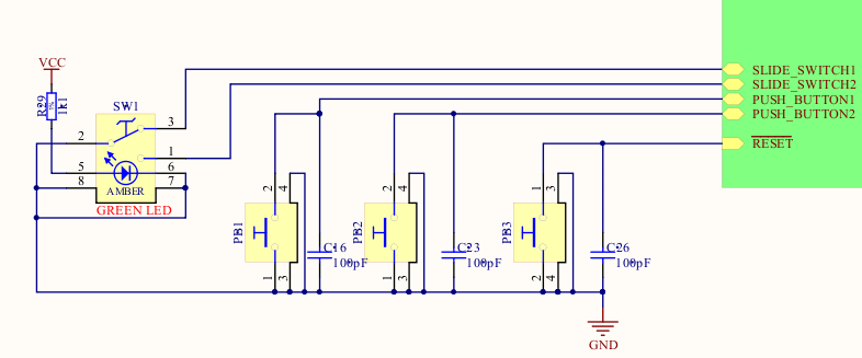

Try moving C16 and C23 next to the processor and add a pull up resistor (also next to the processor) to all three buttons. The built in pull up is kinda weak and having the cap next to the button makes the trace prone to induced voltages on the processor end.
@badservo:
will try the external pullup, fixing C16 and C23 on my current PCB is a nightmare. Not sure can do that.
He is using the internal microprocessor pullup. If he used a pullup resistor of 330-1200 ohms, that load may be enough to dampen the noise. This assumes that he is using real switches. Anyone else have an opinion on internal pullups?
Hi All,
I was pulled into other things so this last test too me a while to finish. I am now using 470 Ohm resistors to do an external pull-up. I measured the ATmega2560 pull-up which is only bringing the line up to 4.75 volts - that was a surprise to me. Now with the external two pull-ups I don't get phantom button presses any more. Thanks for all your input!
One question now remains: should I have a snubber to protect the relay contacts or is that is more a 'nice-to have' feature than a real requirement. What is your experience and best practices?
Markus
Since the relay contacts still produce interference, but not enough to disturb the inputs any more, it seems to be a good thing to have. Or, if you are absolutely sure that the load will be the same all the time, you can go without them.
A side note: The internal pull-up probably brings the voltage to Vcc (5 V), but your volt-meter loads the high-resistance internal pull-up so you measure 4.75 V. That would mean that the internal pull-ups are around multimeter Ri/40, does that make sense?
