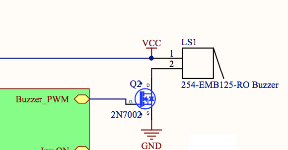

RE: DC/DC converter giving acoustical noise
Keith had the right idea: the piezo buzzer is making the noise.
Any suggestions how to fix that - except putting the entire PCB into a sealed box?
Thanks Solar for coming back with results. It's very informative for us to get confirmations.
I'm not sure how you're driving the piezo.. Hard to offer suggestions. Can you put up at least that part of your schematic?
VE1BLL; Not sure what you're describing. I'm lousy at brief text schematics. LOL
Ah.. Well for starter's, not having a resistor from the FET's gate to ground is a rookie mistake. There is absolutely no guarantee that the output pin of the processor won't leak some small current even when 'turned off'. You're always supposed to include a resistor to ground to 'bleed' this leakage current away.
Try a 10k or a 47k ohm resistor there.
Using any old DVOM, measure the voltage at pin 2 of the beeper. If it's close to Vcc, then the Q2 FET is off. If it's close to 0v, then the FET is ON.
I have tried you suggestions and this are the results:
- various resistors across the G-S pins of the mosfet: no effect. I even shorted the connection.
Then I took a metal plate and inserted it between the buzzer and the cap next too it (the cap between the coil and the buzzer) and that lowered the noise. It seems to me that the noise is introduced only by the EM field of the coil -> buzzer is too close and I have to re-design the board for the next revision.
It is an ATmega2560 and is has a pull-up mode - but I dont see how this would help because it would turn on the buzzer.
In our next design, make the high keep the buzzer off... one less component to put on the board.
I just thought of something... if you truly think radiated EMI is what is causing your problem, swap out the coil for a shielded version. A few pennies more, but it likely means not having to redesign the entire board for one simple component.
MArkus; Even if the resistor isn't fixing the immediate problem 'good design' requires it so don't leave it out of any rev you do.
Have you tried a 200 ohm resistor across the piezo to swamp the magnetic leakage?
I tried even to shorten the contacts of the buzzer but that has no audible effect. It seems this is entirely caused by radiated EMI.
In the next rev I will have to pick a different coil and a new location for the buzzer.
I have a spare buzzer and just holding it next to the coil and the cap makes sound. Unfortunately the coil is SMD and I don't know how to get it off the board.
