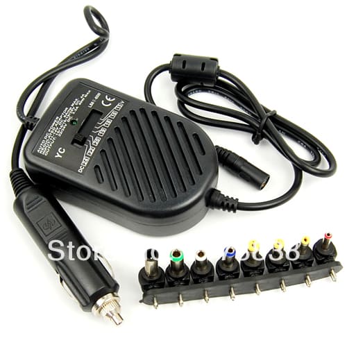

Anything with an internal rechargeable battery should have a socket for charging the internal rechargeable battery. Beside the power input socket, or in the manual, it should say what voltage, current and polarity is required. Is this the 7 volts at 1.2 amps you mentioned?
If so, then you can maybe (still?) purchase adjustable DC regulators that plug into a cigarette lighter socket (universal DC car adapter, example image embedded below) and slide the many-position slider switch over to the nearest voltage to 7 volts. 1.2 amps might be a bit high; most of these top out at 1 A...
If you can't find one, then you'll need to arrange a 7 volt PS. eBay has quite a selection of DC-DC converters (easily meeting these specs), but they would require some wiring and packaging.
