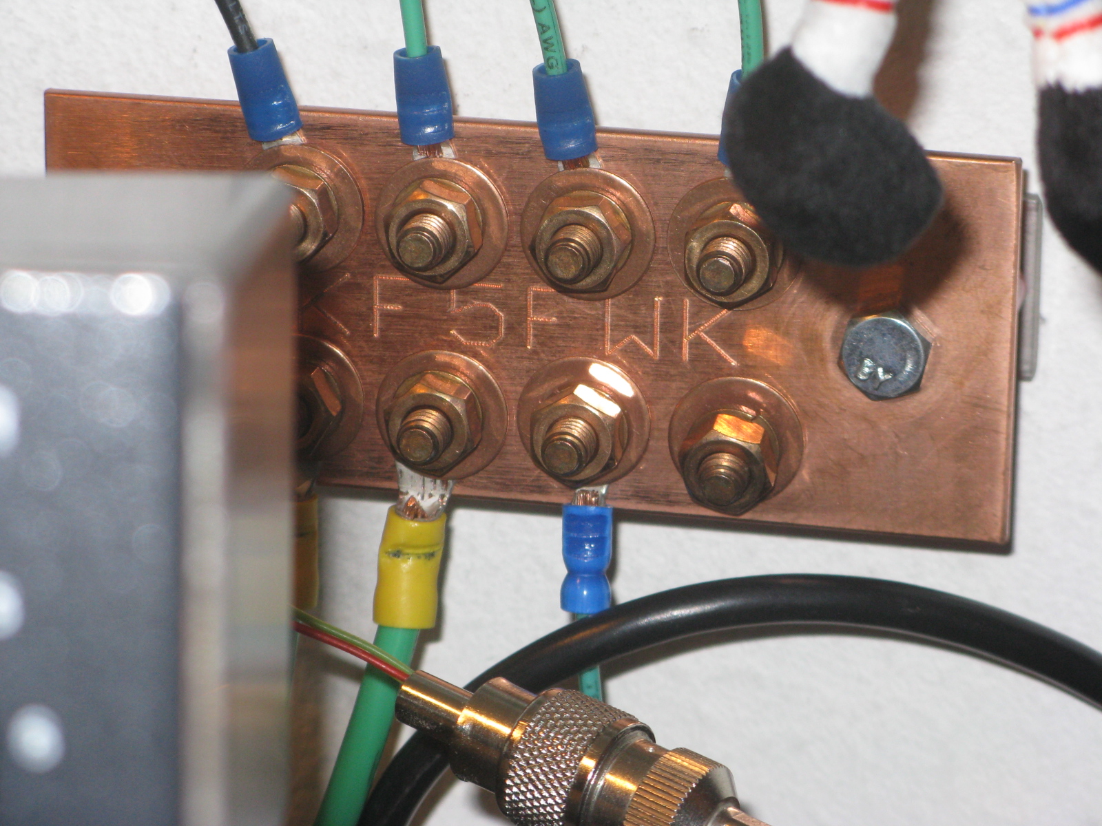

RE: Help with nuts
Use a grounding plate (doesn't have to be this big):
