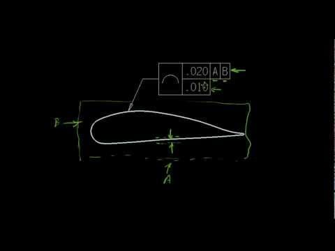

I think this youtube video is dead on to what I am looking for, talking about. (Obviously modified to match our functional needs).
http://www.youtube.com/watch?v=YpS5Sxcl4i0
RE: Dimension GD&T of a complex nylon / plastic parts.
I think we'd need to ad a C datum though because it would not be a constant section view... and then stack that on top of what this shows. Basically we'd almost like to make a cavity for it to fit in...
