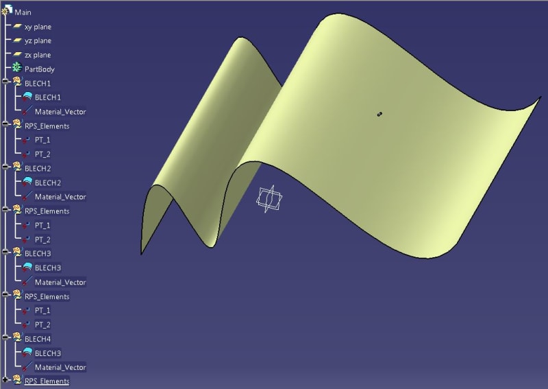

RE: Copying GeoSets from tree structure to one part
Here's screenshot of tree structure of the resulting part + CATPart.
One important update: Every GeoSet named Part_Geometry has a surface which should be named exactly the same way as Part_Name - the name of the part from where set came.
[img ]

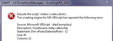

Hi lardman363
Sorry for not responding for a long time ;)
I get an error on line 41:
Any idea what's wrong?
Best regards
try
CODE -->
Dim aParts()
ReDim aParts(iSelectedParts - 1)
______
Alex ,
Hi Alex
Thanks for your tip. Well, I goes one step forward:
Sorry - for Polish language - It's my homeland language :) it says:
Object does not support this property or method
Any idea what could cause that?
Regards
Lucas
I forgot to say, that this macro must work only as VBScript
try
CODE -->
Set aParts(i) = PartSet.Item(i+1).value
______
Alex ,
I get one step further, but now I have the same problem with line 53 :(
CODE -->
For i=0 to iSelectedParts - 1 'CHANGED PartSet.Count

Thank you for your reply. However I do not follow you....ponder Didn't we (actually - you :)) set ActiveDocu like you suggested already earlier?

But I can't get copied GeoSets and surfaces having their parents name.... Maybe you could review this new code and give me some comments / hints?
